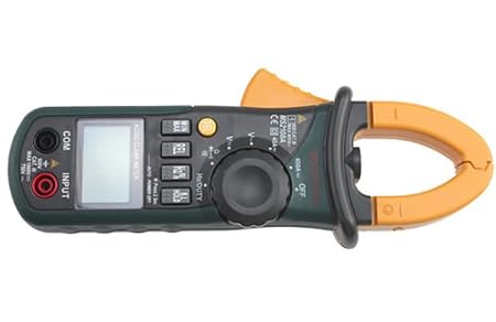

You say car and for DC amps the price soars for clamp on meter but also can get cheap hold on ammeter for DC so it's the car bit that makes me uncertain. Most cheap meters as supplied do not leads designed for mains likely you will need to buy a good set of leads but the biggest problem with new meter users is selecting the wrong scale and burning out the meter.
This is the cheapest I can find at £7 there are better of course but because the current is measured with the clamp less likely to make an error and burn out meter. But this one says it measures AC/DC at £32 very cheap but although it says AC/DC it does not say hall effect would like to see what others say but auto range with just two connections for leads unlikely you can make a mistake to damage the meter.
Started using a clamp on when working in Hong Kong I would never return to multimeter with wired amp range now except for specials. My AVO Mk8 rarely sees the light of day I have four meters I use the other three are specials I do not carry a wired ammeter any more.

As a PS for car amps I used one of these at £18 not very accurate but easy to use. Also a 75-0-75 amp version. Set some pictures as links click on picture.
Thanks guy. I got the VICHY VC99 3 6/7 Auto Range LCD Digital Multimeter off ebay. it looks good enough and at a decent price :)
