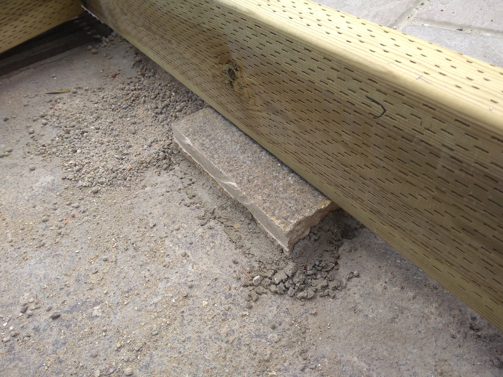

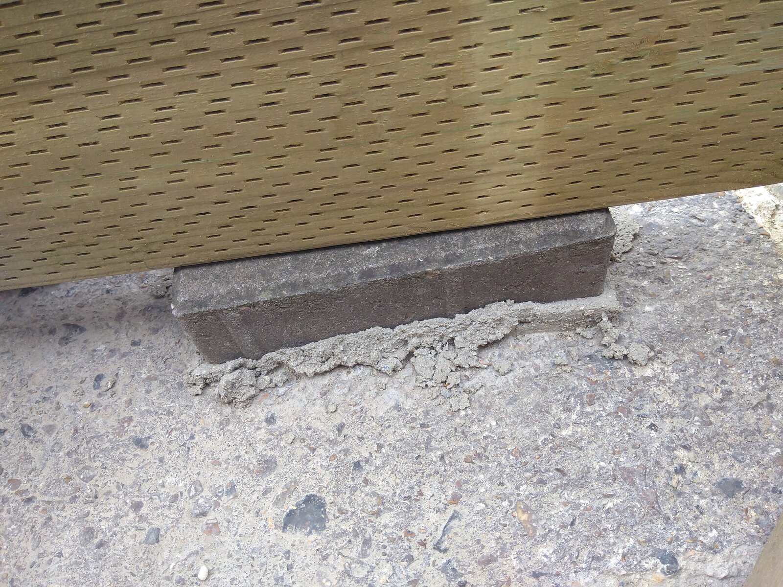

Resin sounds unnecessary how about bedding bricks or equivalent on some mortar?

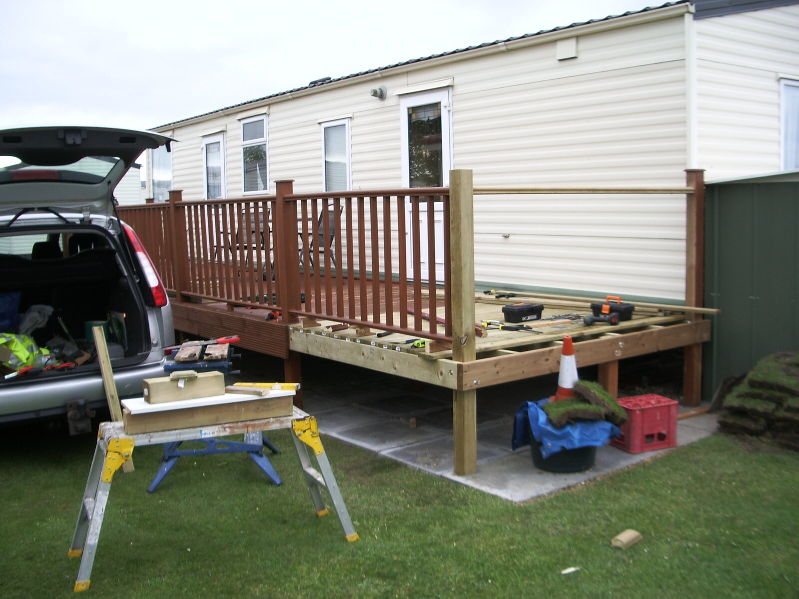

This is my decking put down 13 years ago straight onto slabs still standing and no rot, as long as its constantly not standing in water or moist soil it will survive
Free standing on a piece of lead sheet. Trim the lead to the exact size of the post. ( the photo was taken before the trimming was finished )
The lead seals the end grain of the timber. This was done 40 years ago and the timber which was Tanalised and coated with Sadolin Classis is still in good condition
