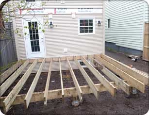

Should i attach a ledger board against the pool wall? I'm a little confused on how this works, if i dig posts in the ground near the pool wall the beams will sit on top and then the joists however the edge of the deck (which meets the pool) will have no support directly underneath.
Something like:
Do the joists need to sit in the beams or on top of them?
Support legs spaced approx 1.2M apart avoids the need for support beams/sub frame - if you want them further apart then you probably need bigger/more support beams - you could probably do 1.8m easily enough - it depends on height etc.
joists are spaced 600mm apart, so you have a support post screwed to a joist, 600mm a joist, another 600mm (from centres) next support post.
With a post spade its 10-15 mins a hole tops.
I'm in the process of breaking up a deck I did `18 years ago and the posts are just standard pressure treated wood and haven't rotted at all.

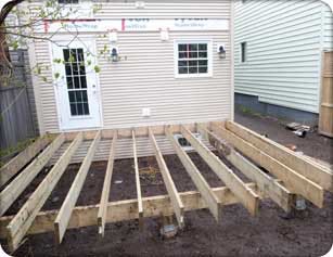

In the picture you posted - there's no way I'd have a bbq or party on that. Though the beam looks about 8" or more. Also if its more than 30cm from ground level - you need planning permission/building control
Thanks for that example, it is pretty much what i am trying to achieve.
'' Support legs spaced approx 1.2M apart avoids the need for support beams/sub frame''
Sorry, but how will the joists be supported if there are no support beams? Am i correct in thinking that as the legs space is 1.2m apart the joists will attach to the posts without beam support underneath?

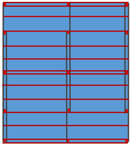

If I attach a doubled up joist and bolt it to the pool wall, could I then get away with fewer posts? My deck will max 2ft off the ground - even less the other end.
Something like the attached pic... (it only has 3 posts.)

Personally I wouldn't go drilling holes in your pool for the sake of a few post holes. Depending on the length of joists you are buying you'll need the posts 2.7 and 3m apart, depending which way you run them. So you should be fine with 125 - 150mm supports.
As long as you add noggins to stop the joists from twisting or flexing under load it should be OK.
Tree roots = Mattock - approx £15 from toolstation.
True about drilling into the pool wall - will avoid that.
If i dig 9 post holes and lay 3 beams (2x5, 2x6 or 2x8?) vertically (x2 5.4m joists bolted together on either side of post) at a spacing of 3m apart
Sit 3m (2x5, 2x6 or 2x8?) joists in between and add noggins as you mentioned for extra support.
ps.... i have been using a axe to try and cut through the roots. Will get hold of a mattock.
150mm so 2 x 6 - If you can get 6M lengths just overlap them rather than cutting them down - you'd need 20.. If you can get 4.8M lengths then you need 22 and another 6 post holes would make the perfect set up. Another 3 for noggins, but you could get away with 2 x 4 or 2 x 5 for those. My quick calcs suggest 4.8M is £100 cheaper
