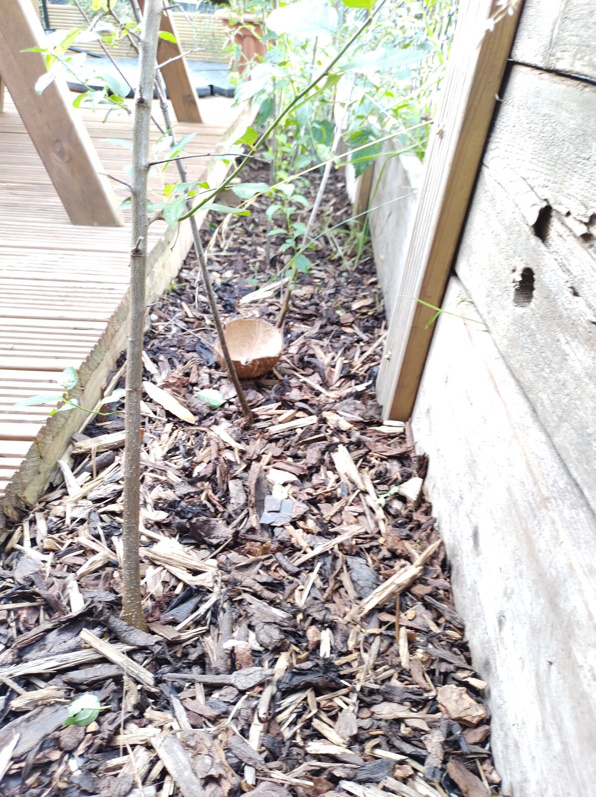

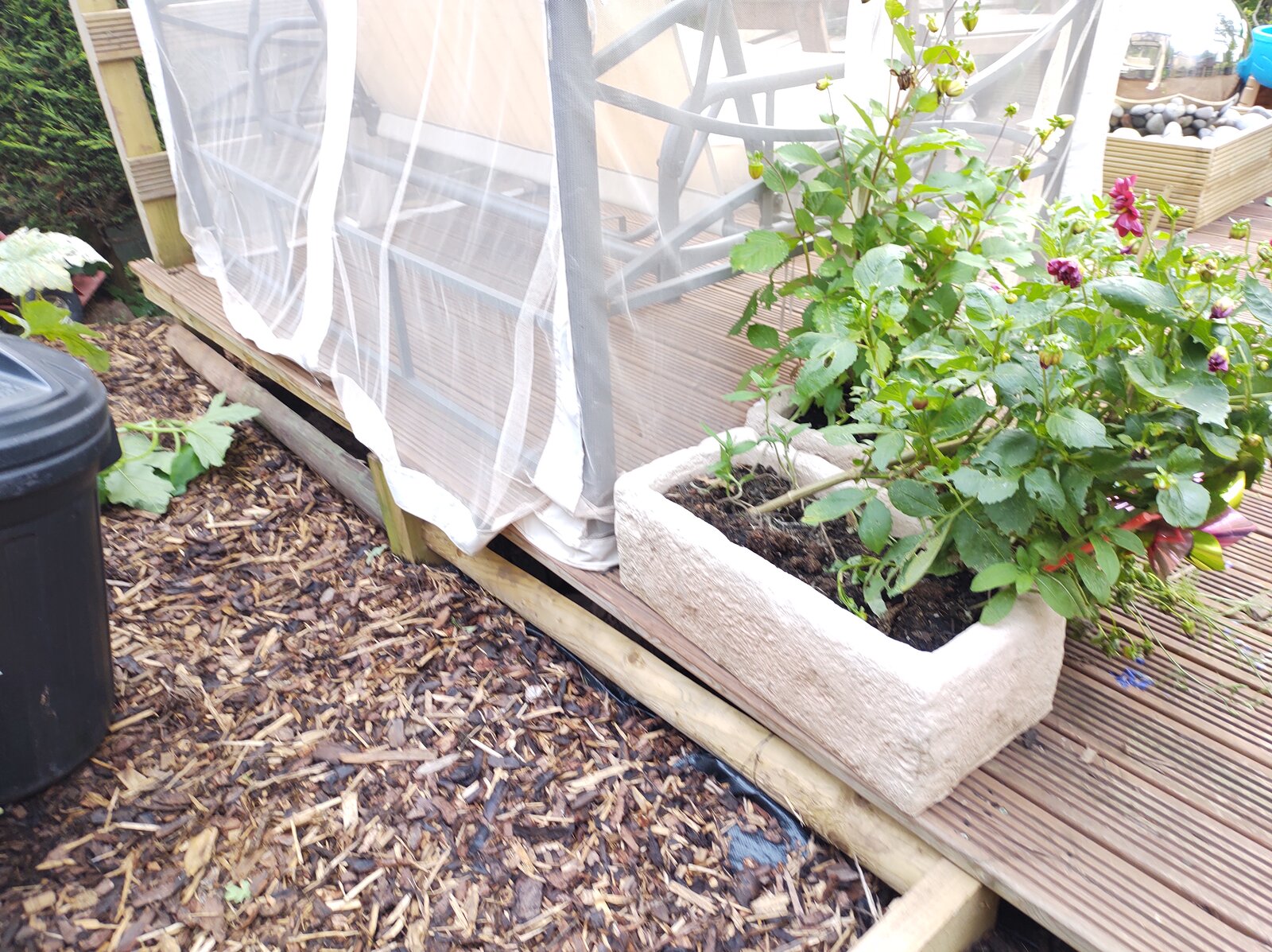

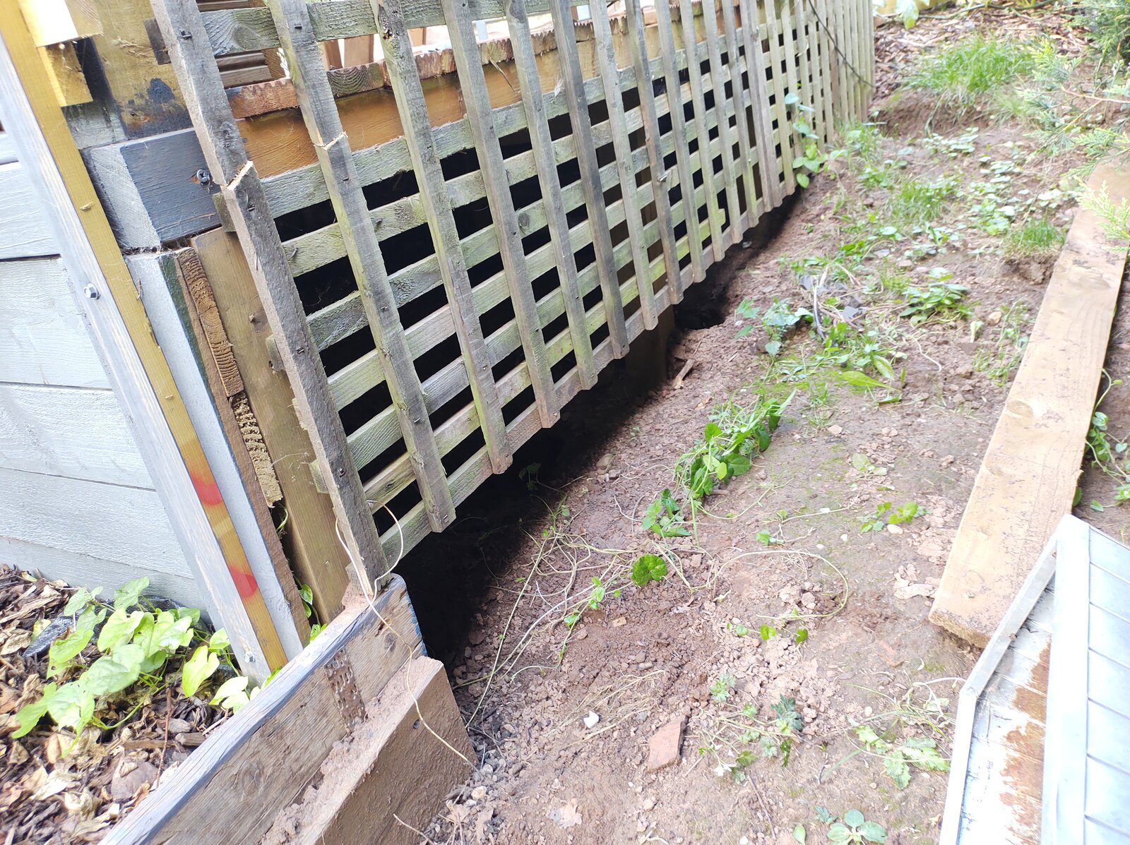

It’s part of the natural ground.
The rise at the top closest to the fence is about 5-10cm at most. However, the rock slopes down to the ground, I think one corner will be about 35cm
The rock that is uncovered next to it is much higher.
As it’s part of the natural ground would this class as the highest point of the garden?
Measured from a point on the highest adjacent ground.
Would the rest of the rock count as adjacent ground?
If I stand on the rock I can already see into neighbouring gardens.
1. Adjacent = right next to.
2. Is the rest of the ground made of rock, or has the rock just been plonked there at some stage?
If yes to both then it counts, and that's where you measure from.
The rock is part of the original garden, you can clearly see the base of the rock.
The gardens have been cut into the ground where the rock was and some was left behind.

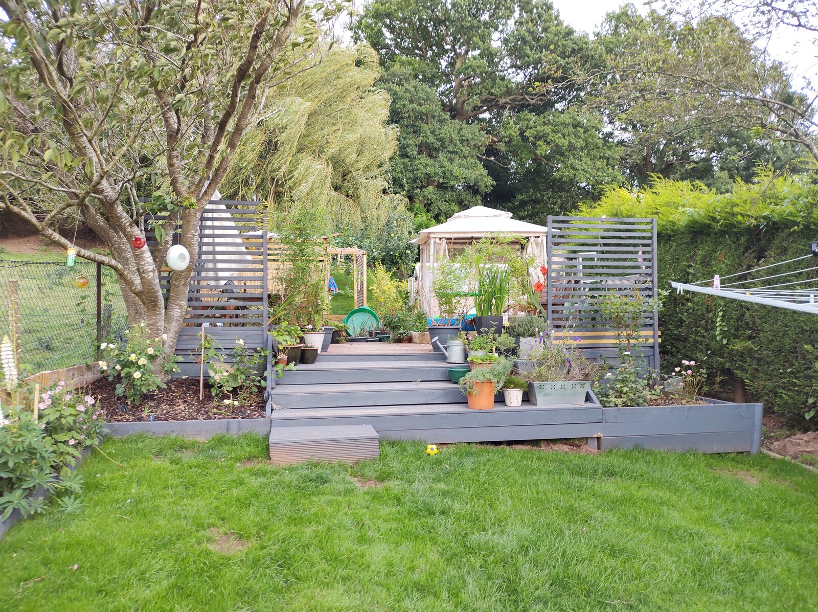

A year on and now established still only 30cm from ground at highest point that the natural land liesIMG-20200822-WA0032.jpg IMG_20200822_183816876.jpg IMG-20200822-WA0032.jpg IMG_20200822_183816876.jpg IMG_20200822_183907547.jpg IMG_20200822_184112150.jpg
