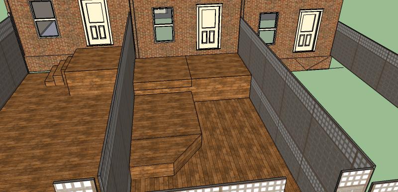

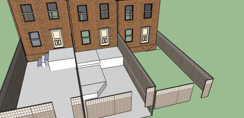

I've been playing with Google Sketchup for the last couple of hours and although it was a pain at first I'm getting the hang of it now, here's what I've got so far: (I'm the middle house. Note this isn't to exact scale, also the walls are stepped down towards the end of the garden so the overlooking is slightly worse than these images would suggest )
I've spoken to the council planning dept and they say there would be a site visit and a consultation period with neighbours with the main concern being privacy. They say no building control is necessary too unless the deck reaches first floor height. Neither the website nor the phone call told me of any peculiarities with rules.
I don't really know my neighbours well but at least I'm not on bad terms with any of them :) But yep I should probably contact them before applying, even though it might draw my application to their attention. Would they automatically get a letter in the post explaining what was happening after I applied?
