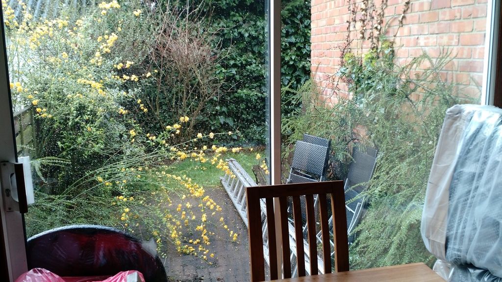

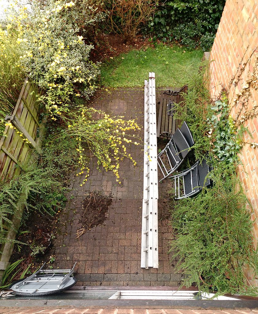

Here is the area im hoping to deck:
Ill be pulling up all the trees and bushes as they are just overgrown and The area isnt very big so id like to use as much as possible for the desk as its the only part that gets the evening sun. The deck will stretch right out to the fence at the back. the space is 6m long by about 3.2m wide
Id like the deck to be level with the interior floor, which should be possible if i pull up the pavers which are no use anyway.

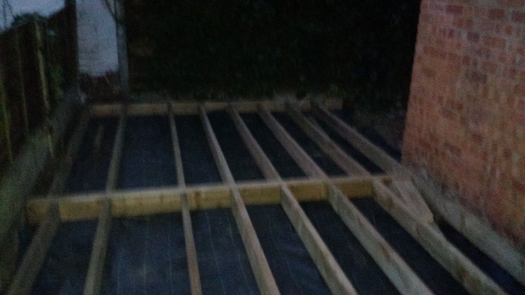

The plan is to use 6x2 laid onto 6 concrete slabs 600 x 600 the biggest spans are 2.1 meters wide. im hoping this wont be too much, i read 2m is ideal for 6x2 but im hoping the extra 10cm wont make a huge difference.

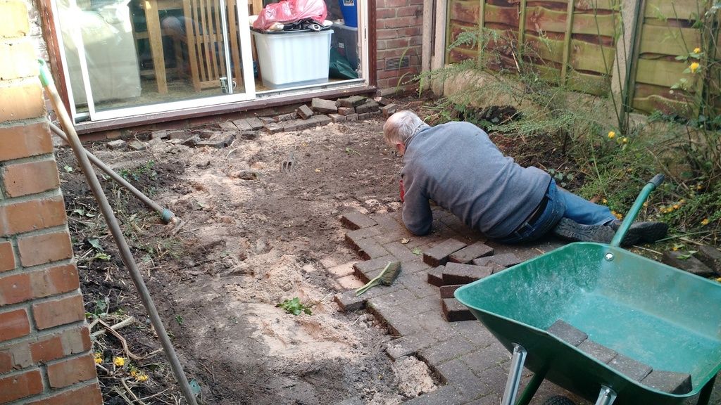

Day one was lifting and cleaning the block paving, the bricks can be used for the drivway
end of day 1

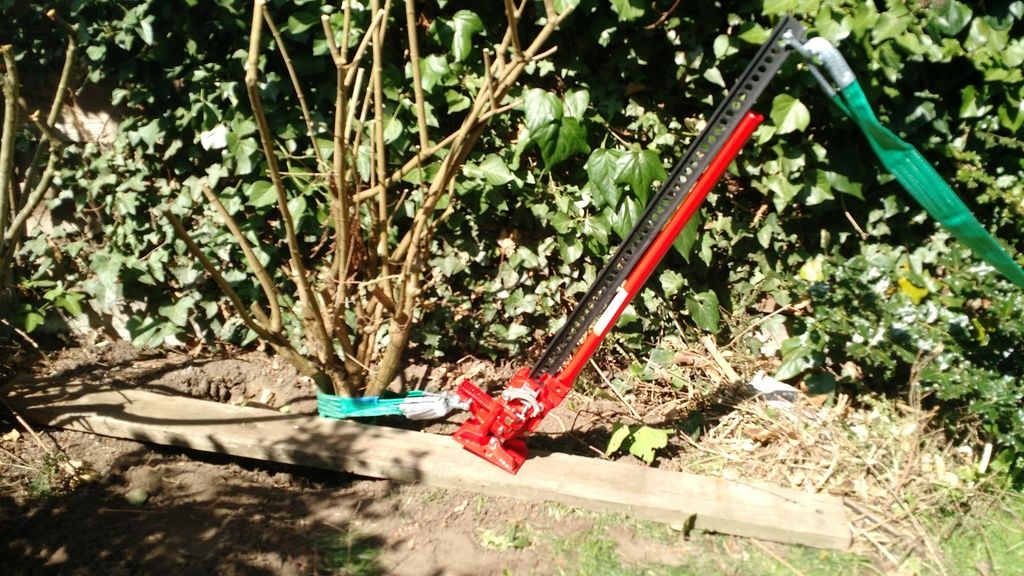

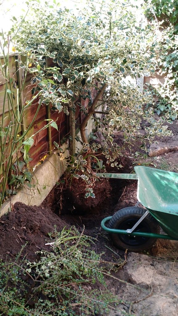

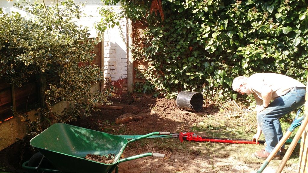

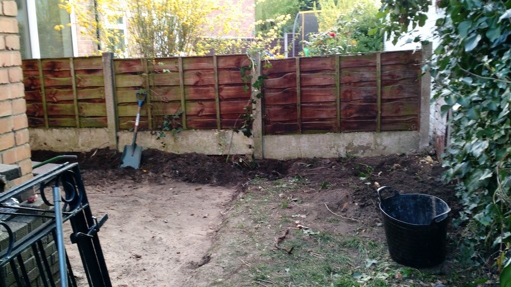

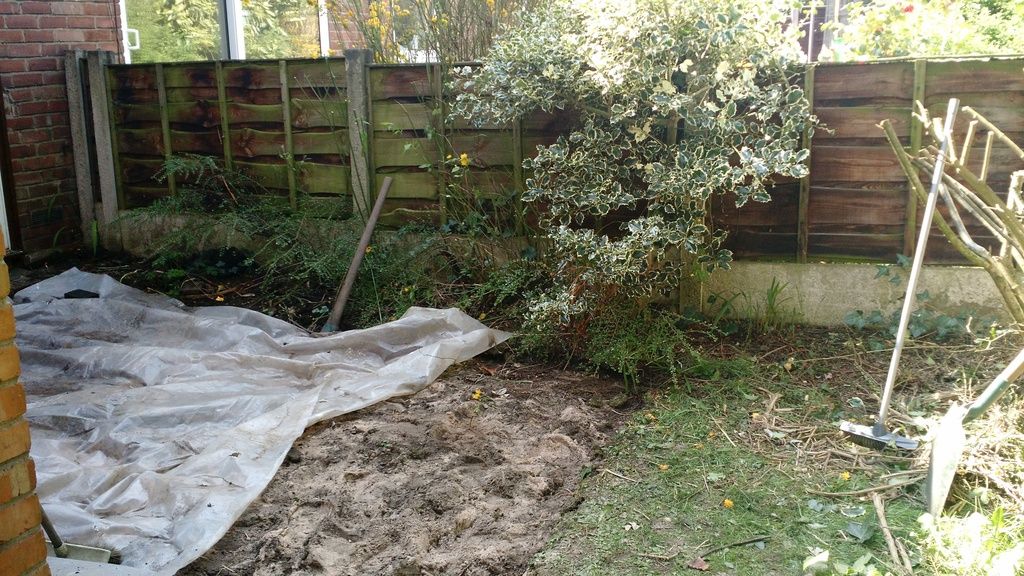

Day 2 Was to attack the overgrown plant life
we saved this holly bush for the front garden

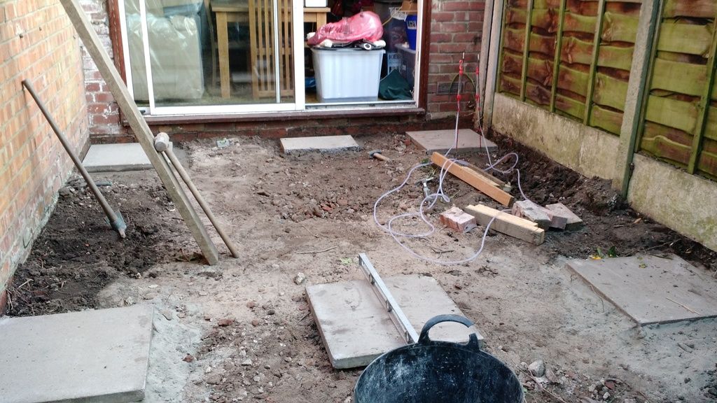

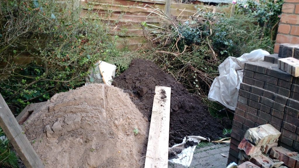

day 3 was laying the slabs, we laid them all on a cement base which was on top of a deep stone footing that we packed down. we also had to move a load of top soil from the bottom end of the garden as the garden was higher than the house here by about a foot.

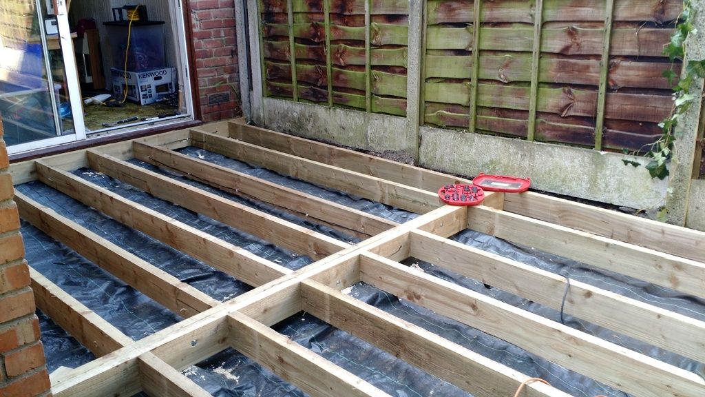

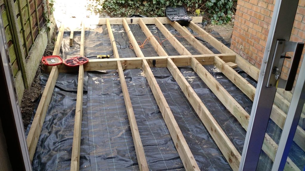

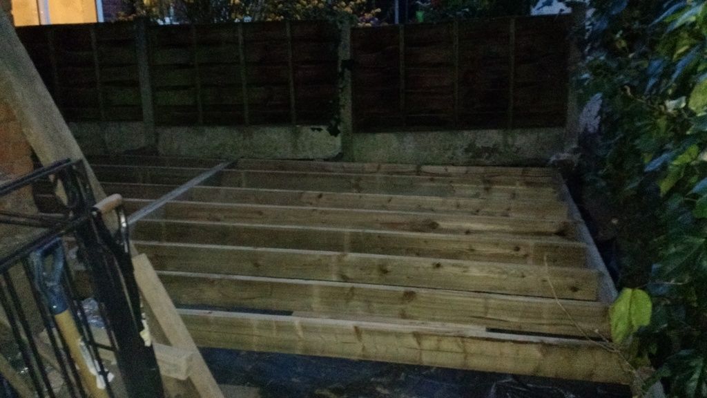

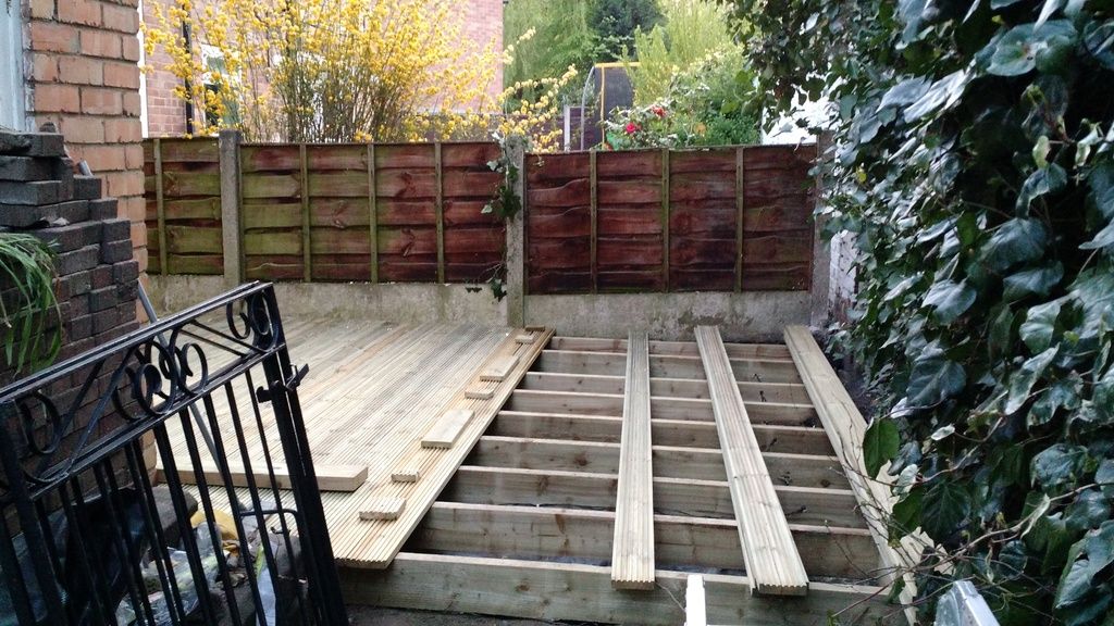

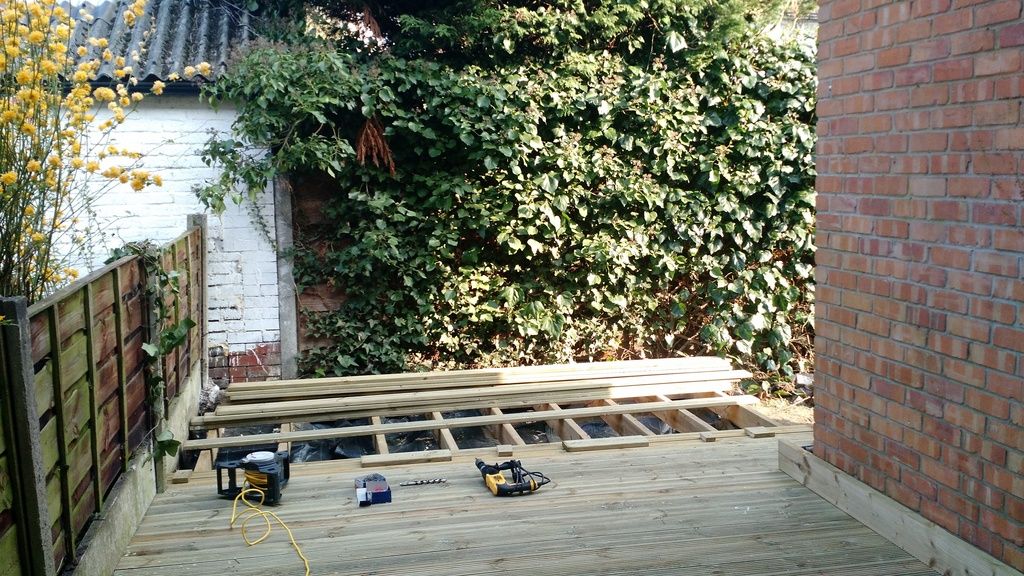

Finally on day 4 we started building the deck frame

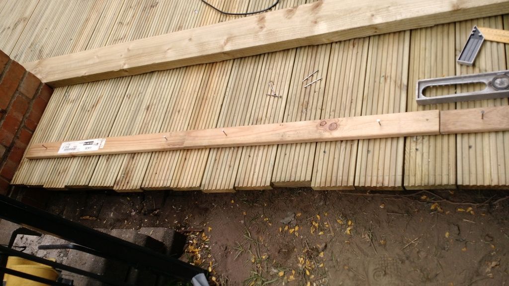

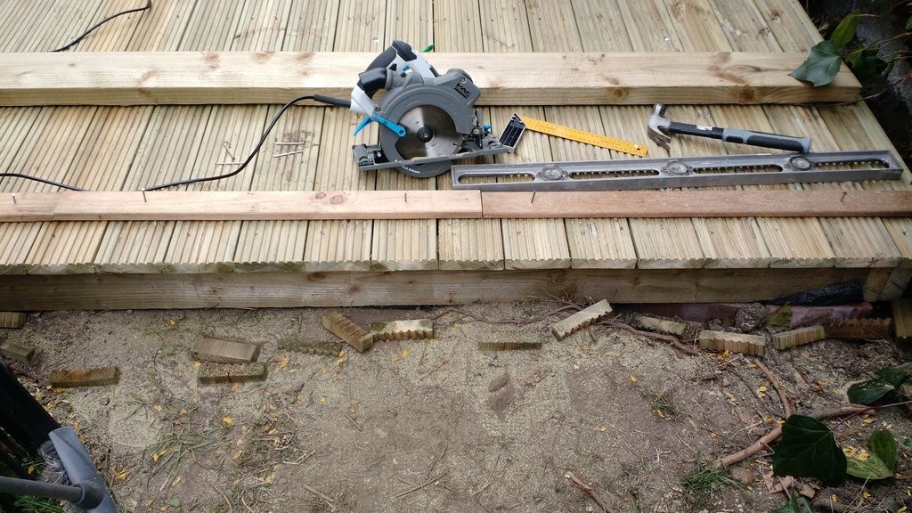

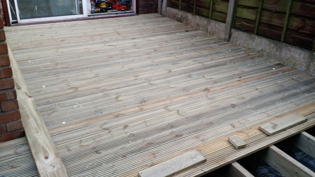

On day 5 we started laying the boards

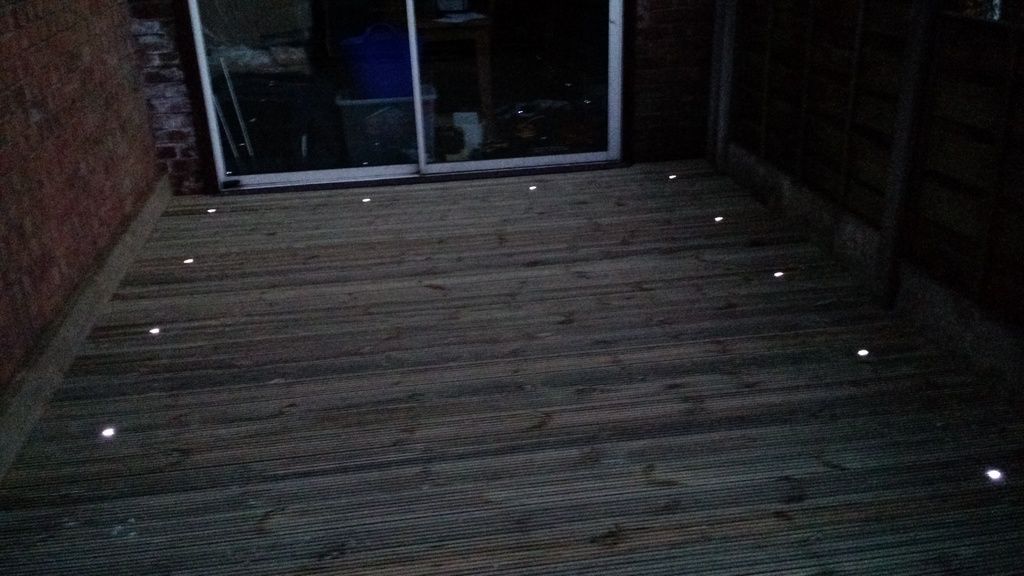

Put the deck lights in place as we went a long

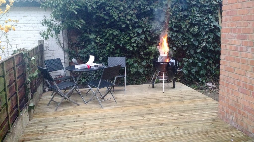

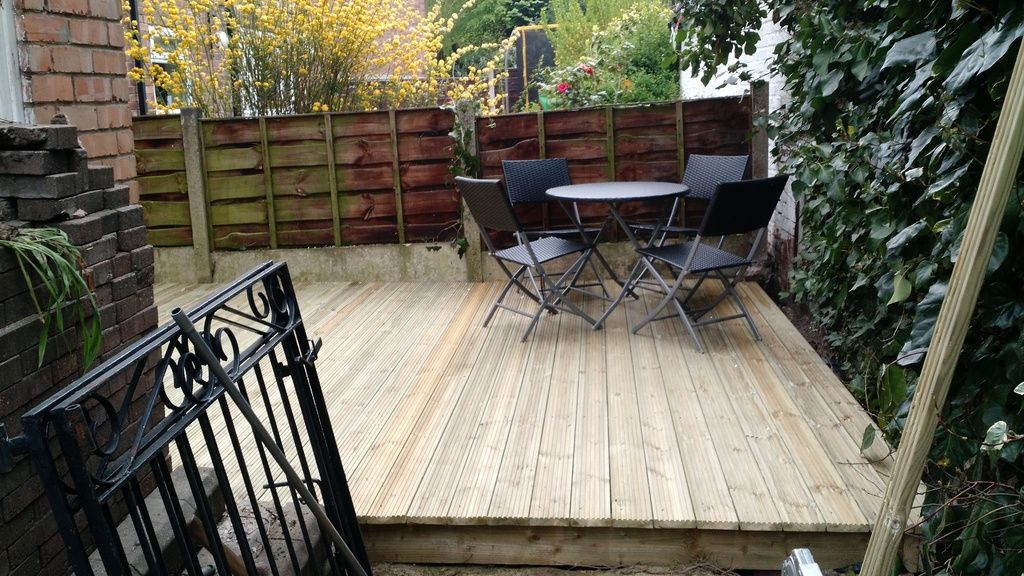

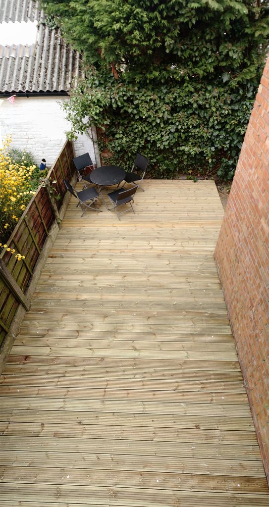

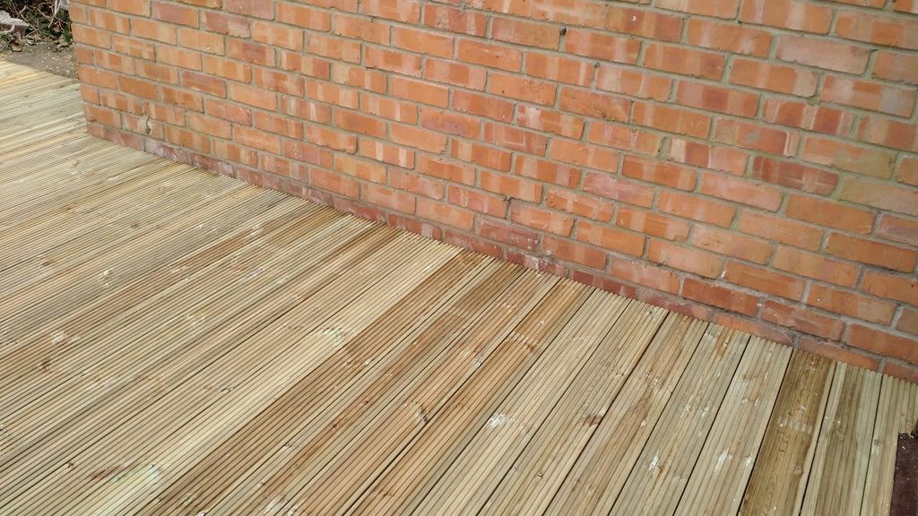

day 6 we finished the last boards and sorted the edges
All done, a few things I's like to do to make it look nicer, but the deck itself is done.

May I ask if those LEDs are solar or mains connected?
The LEDs are 12v Mains connected. Ive never really seen anything solar that was very bright
Noticed that you had no supports on some fairly long joist spans. How did this work out? Looks great by the way!
I compared a few span tables i found online, I cant actually remember the specifics now, but the spans were well under what the recommended for 6x2
