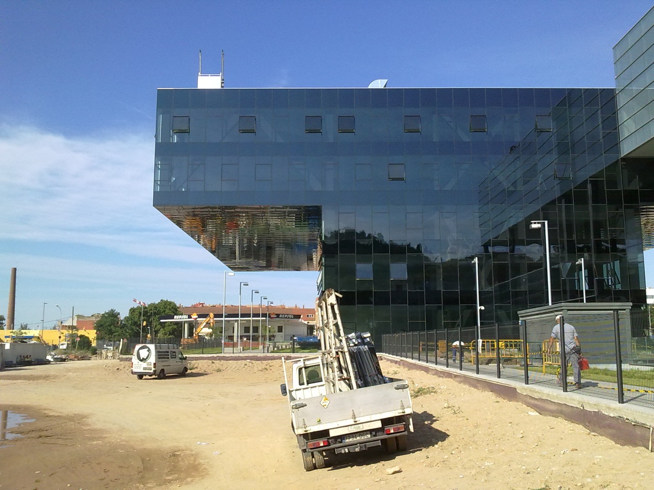

Can't you cantilever the deck over the stream, you shouldn't be placing supports in the water at all. Anyway concrete sets in water.
How far can it be cantilevered ie what distance?
Whether it is in the stream or not it is running next to it so pretty sure wherever I dig will hit water at some point so just need the best solution for securing the supports
Impressive, but is there any set guidlines or general rule of thumb?
