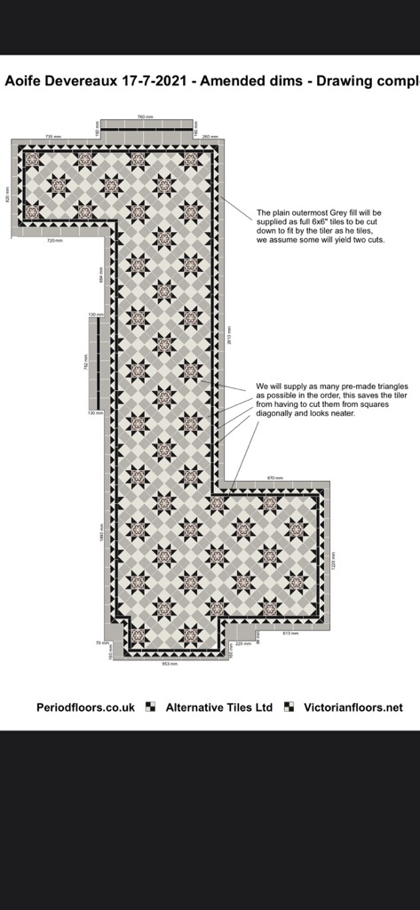

My customer is going to have his hallway floor tiled with small diagonally orientated square porcelain tiles.
The base is floorboards with 6 or 9mm ply over the top.
The tiler started laying them last week end but didn't leave any grout lines so the customer came in on Monday and lifted them back up (and cleaned them).
The client is happy to let the tiler have a second go but I have some concerns- the tiler didn't use SBR etc on the ply. I am wondering if the floor needs a decoupling mat or not.
I appreciate that the response might be to find a new tiler. I have seen other work that he, the tiler, has done and considered it to be OK. The customer, a mate of mine cannot move in until the floor is done.
Here is an image of the layout (not showing grout lines though).
