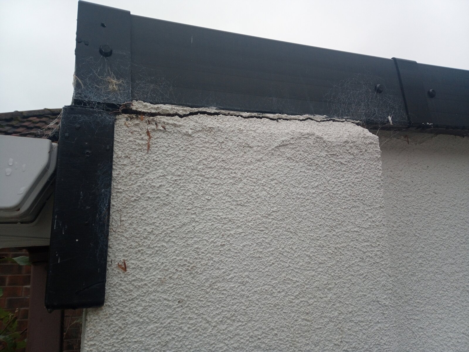

Hi all what is happening here please?
Yes as above.
The pier should be either lower and a cap detailed, or the roof edge extended past the pier.
