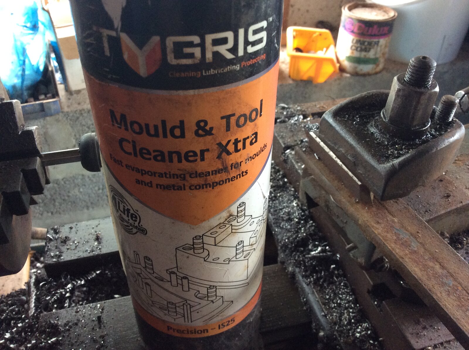

I have a small alloy casting in old binoculars, probably been dropped and broken, that I want to repair with Araldite.
The mechanism is intentionally greasy
I cannot dismantle it out
Can't use a spray or heat
I want a liquid I can use with a brush or Q tip that won't leave an oily residue
I have white spirit and car paint thinners and isopropyl
Any better ideas?
How about something water based? I think some bike chain cleaners could be okay.
brake/carb cleaner? watch your eyes and spray some into a cap/egg cup
You need a thinner that will evaporate in its entirety, so isopropyl alcohol is probably the best bet.
Car paint thinners would probably be the next best option as they are also designed to evaporate to nothing. I wouldn't use white spirit as that will leave a residue.
When you say you can't spray, could you use a spray can of carb cleaner (alcohol) with a pipe on the nozzle to direct the spray? Sometimes a blast from a spray can is the best way to blast off grease from cracks and crevices that a brush or q tip can't get into.
Spray into a container to brush on but would need to be quick as it evaporates a bit rapid

I can't let any overspray, or grease particles, onto the optical glass.
Carb cleaners are usually "ether" which covers a multitude - some are more water soluble than others, for example.
I'm sure that Tygris would be great - may get some.
If yours isn't ferrous rust won't be an issue, which it often is.
Alcohol, usually propanol or IPA, (IPA but not the Ale) is pretty good with greases but not quite up to acetone, which is of course very dissolving of many things, and quick to dry. You need it 99%+, not nail varnish remover. Just don't order high % hydroen peroxide at the same time...!
Oils particularly ( which includes most greases) dissolve well in what the Americans tend to call "naphtha" which isn't very specific but hydrocarbons. Our goto equivalent is lighter fluid, which eg a locksmith will use to clear gunk out . It's good. Car petrol isn't bad, but has a million additives.
The ultimate dissolve-everything jizzm (it'll have a go at a kitchen laminate) is graffitti remover, it's vicious but damn, it works.
Remember with any of these, you have to remove the liquid before it evaporates, otherwise you just distributed your grease nice and evenly.
So paint some on, soak it up in a lens tissue, and repeat.
For replacement grease you can use a light lithium grease, though there will be tight tolerances on the original - some optical greases cost several hundred dollars for a tiny bottle. Look at "Nye".
But never never never ever be tempted to use silicone grease on anything optical,. It waits until you aren't looking and spreads itself one molecule thick on all the surfaces, including the glass and it's impossible to remove.
If you do get any (normal) oil on glass, this stuff is the d's b's: http://www.newprouk.co.uk/ROR-lens-cleaner.html
It would probably work well on your fracture surface, which will have many nooks and crannies. brittle fractures show a lot of grain boundaries, like mini broken expanded polystyrene. More ductile fractures have tears, and won't fit back together so well. May be too small to see.
Apart from things like camera sensors, I've used ROR on spectroscopic, laser and imaging equipment. £20k per lens, in some cases.
It is wet, you do have to remove it with a lens tissue (NOT a Kleenex), but it's awesome. Dry with IPA or acetone.
All of these need to be used in a exceptionally well ventilated area with no ignition points.
