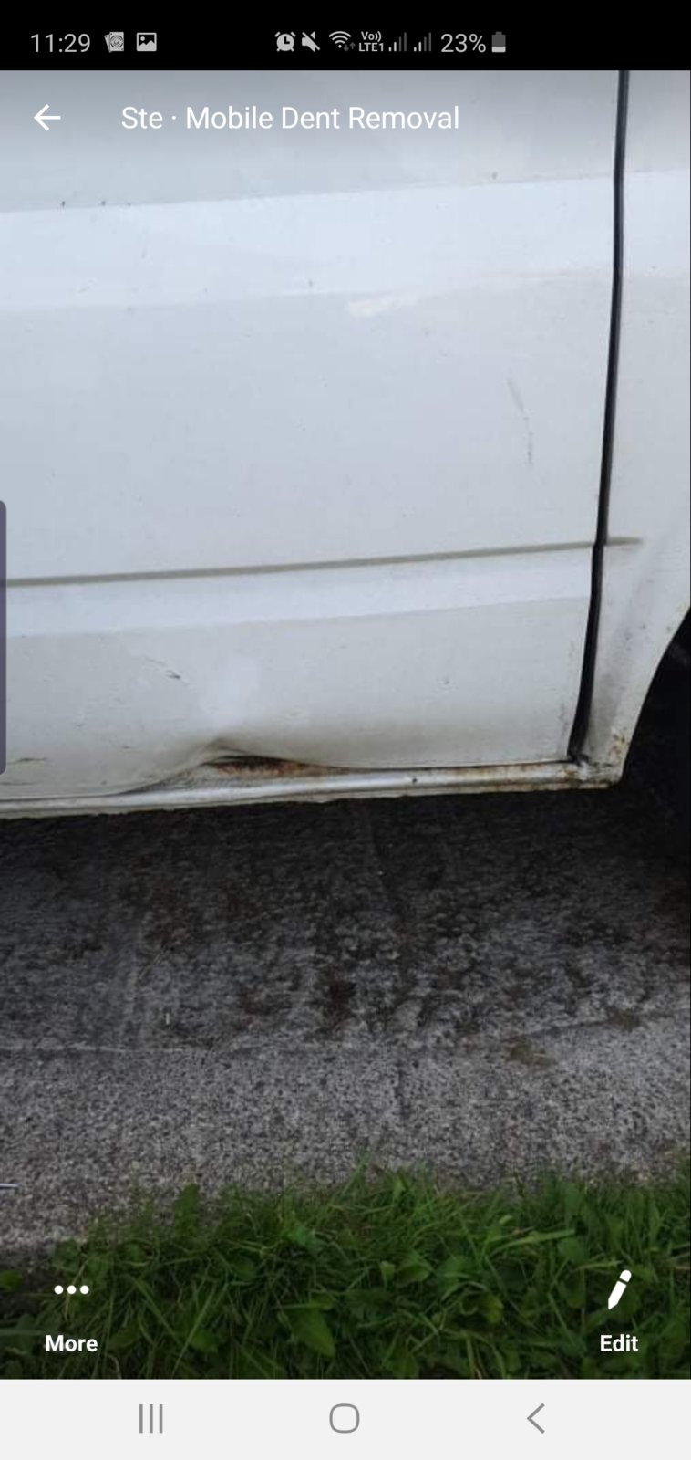

I am just wondering if I can somehow pull this van door dent back into place. Doesnt need to be perfect just looks like I could get under neath with a crow bar or perhaps bang from inside? Like I said not bothered about perfect just want to improve
Quite an awkward dent, that one as the area at the bottom of the door is heavily double skinned and folded so it's going to be tough to pull out.
I'd only really attempt that one with the door off but you may do something if you brace the sill with a heavy duty piece of timber and try levering with a long hooked wrecking bar.
A second hand door may be available of course, if you can put up with the faff.
