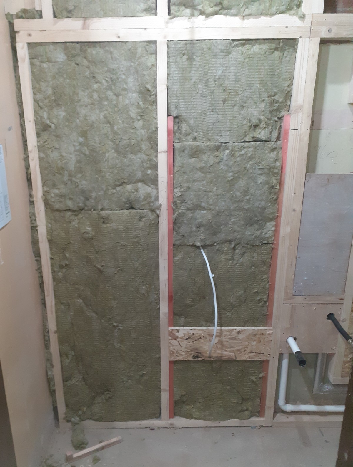

Half of this very tight toilet wall was framed floor to ceiling, the rest was carried on blocks fixed flat to the wall and screwed to the shortened frame which stops just above pipework. Note the waste pipe going off to the left - there was 5 ft of pipework there with a 9ft high wall above it which couldn't run down to the floor level because the low level kwaste pipe got in the way
Note that the framing had to be installed in 4 separate pieces, screwed together to form a single wall frame, because of access issues to this room. The weight is almost all carried by the wall at the right hand end of the framing, NOT the ceiling, but the plasterboard skin helps. A thin skin of plywood over the entire wall, say 6mm, would greatly increase the load carrying capacity of the framework. Sorry not the best image, but hopefully shows it can be done
BTW 7mm holes, brown plugs and 5.0 x 100mm screws were used to fix the blocks onto the wall, mostly two per block. Frames made up with 400mm centres where possible
