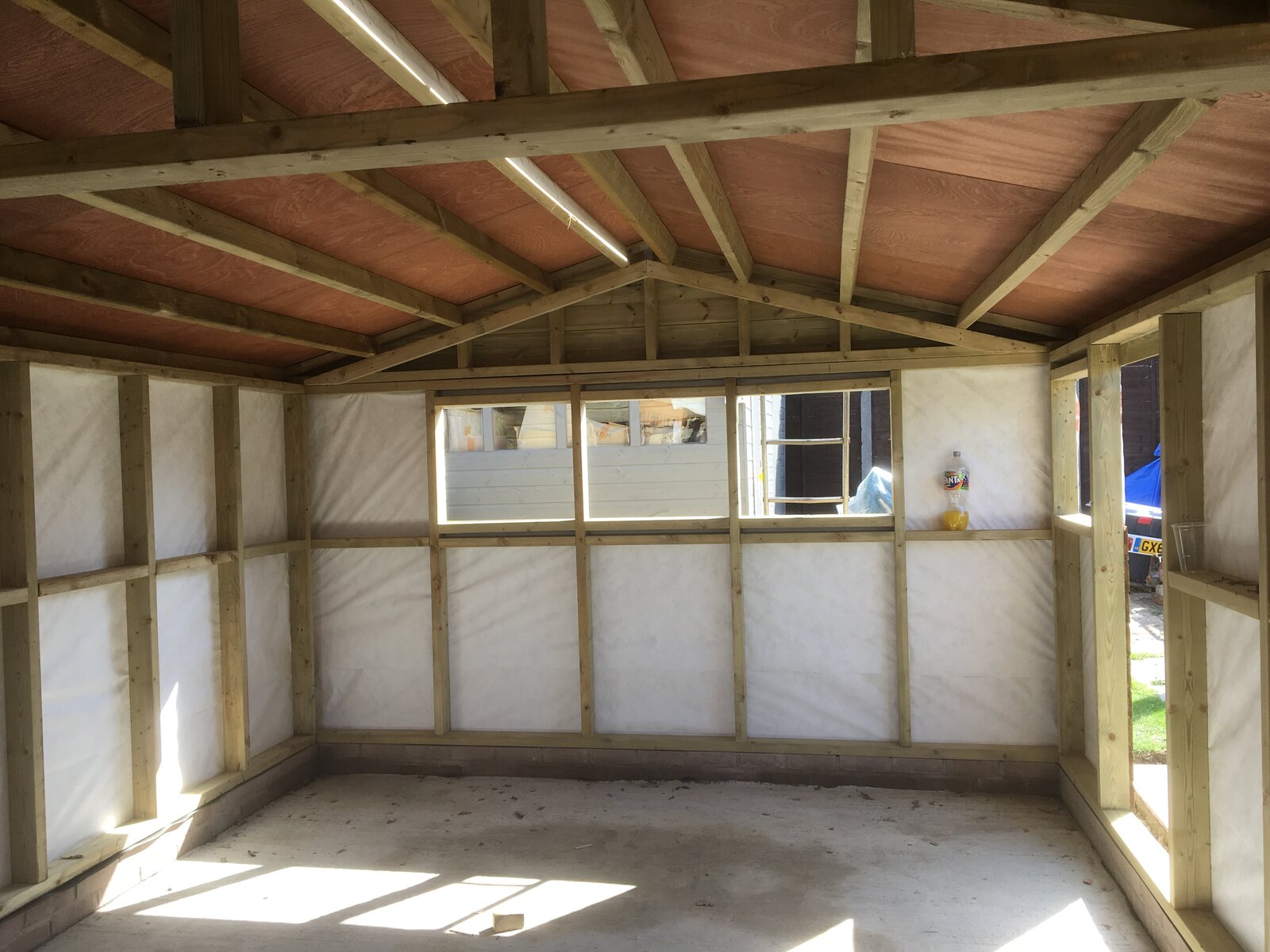

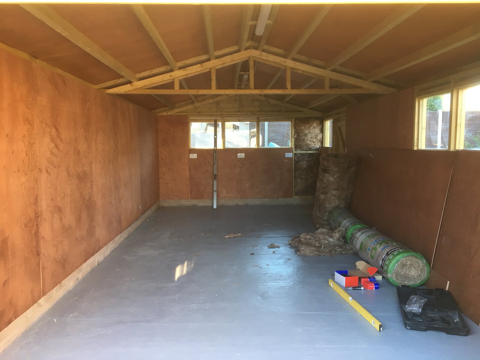

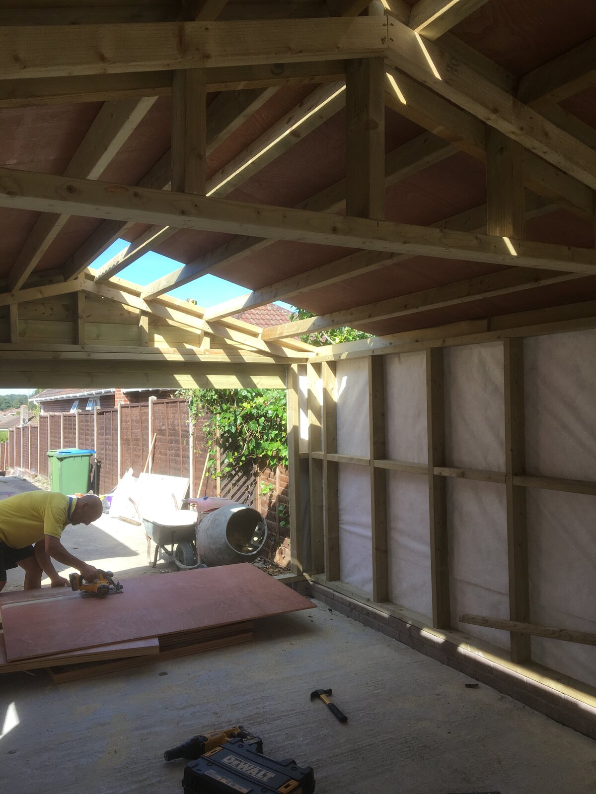

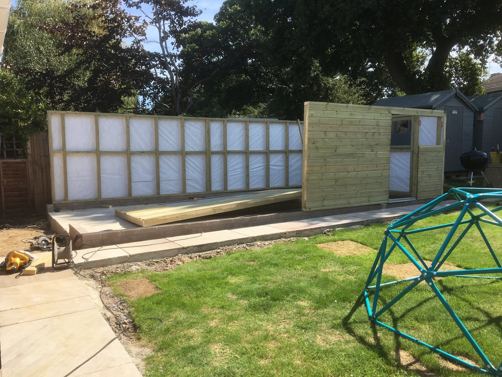

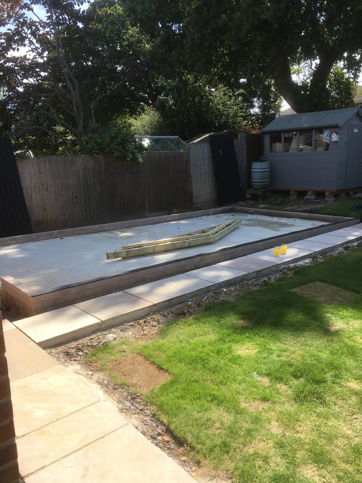

Here is mine
There is a dpm between the brick and wooden sides

Each to their own. I’m happy with mine and a timber floor would be useless in a garage/workshop.

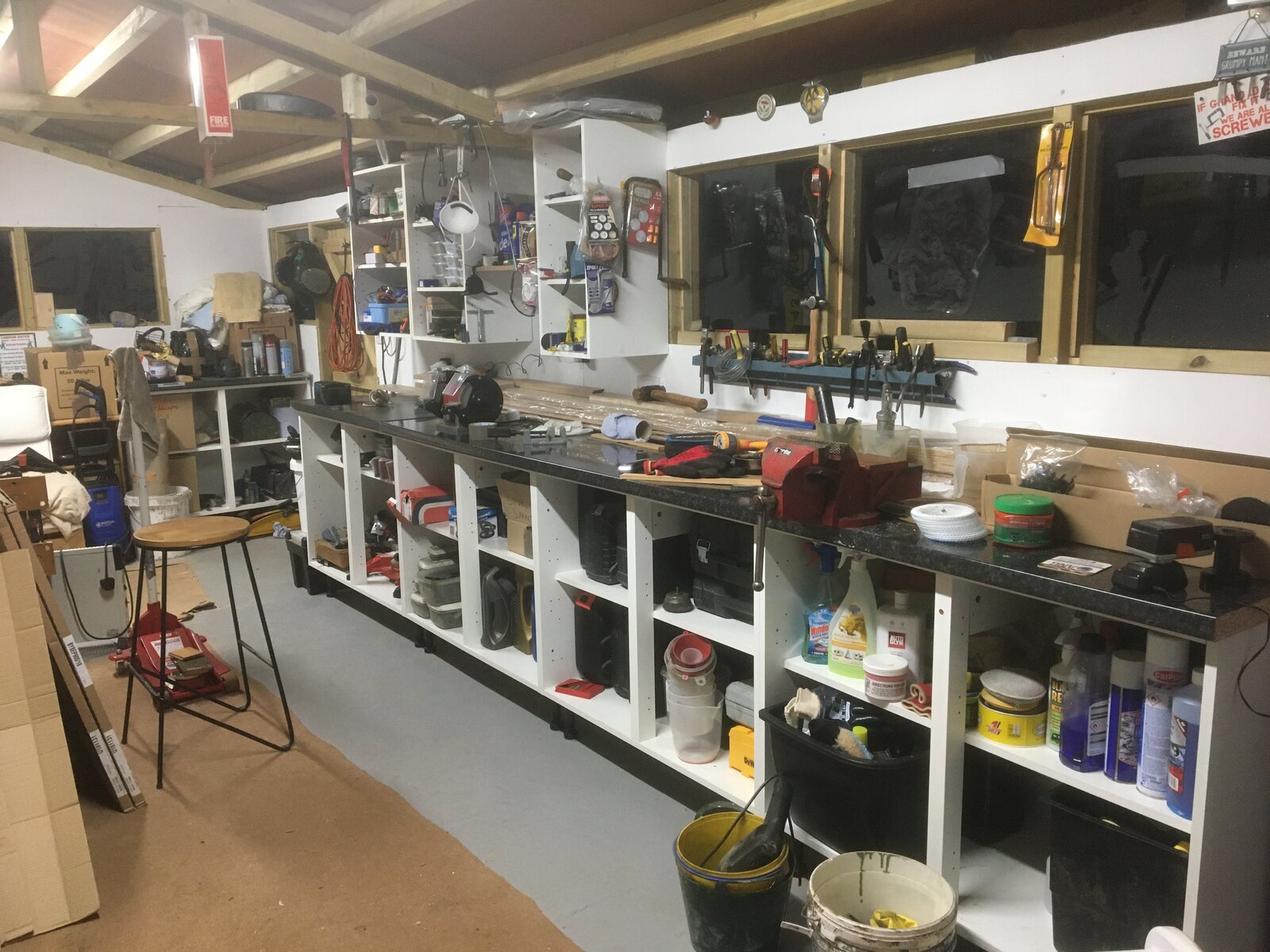

Its about 3.5m x 7.0m. Takes a bmw 1 series with standard kitchen bases and worktop down the long side. Then a row of cabinets across the short side with desk and walk through space.

Mine is bolted through the timber to the brick course with dpm between. The frame is mostly 4 x 2. Now has DG windows with framing to suit the opening. Insulated behind the ply panelling with an onduline roofing sheets also with ply boarding. Its been up about 4 years now.

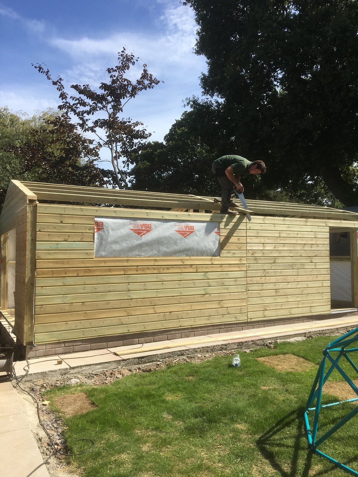

Here's a couple of outbuildings I have done recently - one block and trusses, the other SIPs
