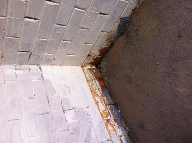

I have a detached brick garage (built 1986 ish) it has a flat felt roof and is single skin of bricks I think. I can see the black layer (damp proof course) 2 bricks up from the bottom of the garage.
I want to put a door in on the side of the garage and make half of the garage a clean room, so when you walk in the side door its a self contained little utility space. From the research I've done, I think I'll construct a wooden frame inside the garage, with a raised floor. Insulate the whole thing and use chipboard on the floor and plasterboard everywhere else.
QUestions is, how do I sort out my damp garage floor first? and has anyone got a simple step by step guide for a DIYer to follow to make such a garage room? Happy to do the research and reading..
Will I need to get a new damp proof course put in, or tank the garage?
You can see from the pictures, I painted the whole garage about 2 years back, which makes it easier to see the problem. Apart from the bottom left area of the garage, the rest seems pretty dry. I've organised for a new roof to be installed next month, as the felt is due to be replaced. I'm also getting a storm drain fitted that will run across the front of the garage door so no water should get underneath the door and run down to the back of the garage (it slopes to the bottom left).

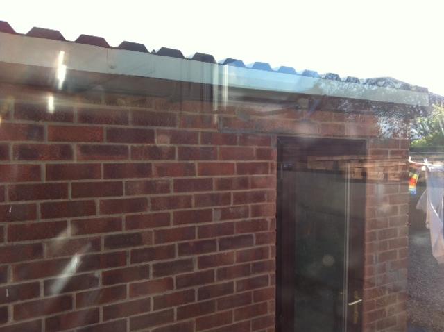

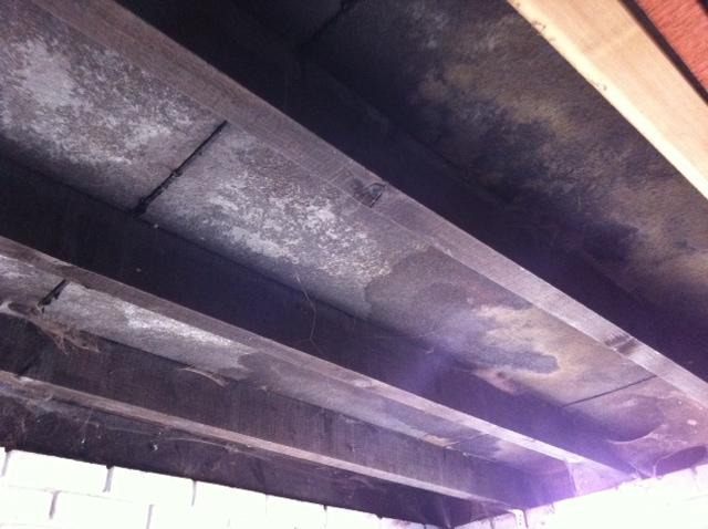

I've had a side door installed and a new metal roof over the existing timber/felt - 30 yr guarantee included :)

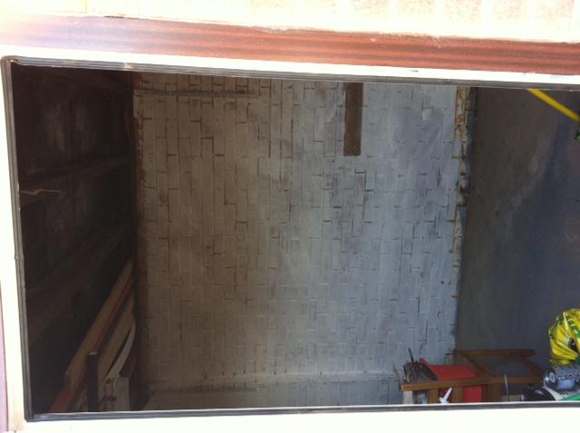

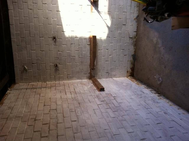

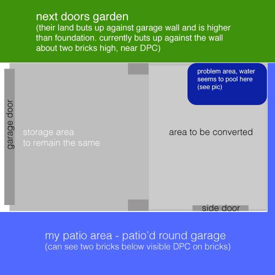

Decided to go for concrete on base and have created the holding frame ready for the concrete pour. So just after a little more advice before booking that in. Do I place the membrane on the existing concrete floor and tape it up a metre around the Walls then pour in the concrete two bricks up (up to the dpc visible on the bricks) ... Then stud frame, insulation against brick Walls, plastic then plasterboard, skim and finish. Am I missing anything? Thanks.
Some pictures may help..
top corner where water seems to pool and perhaps coming ion from next doors garden?
view from the up and over garage door looking to the back left of the garage
ceiling timber, now has a metal roof over the top of the timber/felt roof
view from the side door looking into the garage
side door into garage
planned garage layout..
