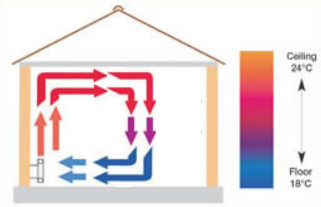

Our house is built into the side of a hill, and at ground level to the front we have a downstairs hallway with front door, and access to the garage via an internal door. All other accommodation at one and two floors up. The original builders didn't fit a radiator down there, and for years we've been using a little portable panel heater - coiled radiant wire design, as far as I can tell, rated at 500w. It takes the chill off, but doesn't really warm the place.
We're getting a wall-mounted oil-filled radiator fitted, but trying to judge what rating to get. Want it to give more heat, but not go too high so that we're wasting money on a more expensive one that we don't need.
I'm told that the thermal oil in them makes them more efficient than the equivalent panel heater like ours, but if we go for a 500w oil-filled, will that be noticeably warmer than the current panel heater? Should we go for a 750w or 1kW?

All resistive heaters have the same efficiency. Using a heat pump, or inferred can change it, but the difference between a panel heater and oil filled radiator is the hysteresis, there needs to be a time between heater switching on/off/on etc to maintain the temperature as other wise the contacts would wear out, and the heat held in the oil bridges the gap, so heat is being delivered all the time, idea is the heat has natural thermals within the room. circulation3.jpg from your description not sure that will happen, with inferred it heats the person direct not the air, but that means it can't be thermostatic controlled, only way to control inferred is to have multiple bars so you can select how many are used.

If 500W is not enough then fit 1kW, but make sure you get one with thermostatic control or fit a wall-mounted thermostat, that way you can control it to your liking and not use an unnecessary amount of power. As others have said, oil-filled will have a longer time constant which may help.
Go high, you can always turn it down. Go low and if it ain’t enough, it ain’t enough!
