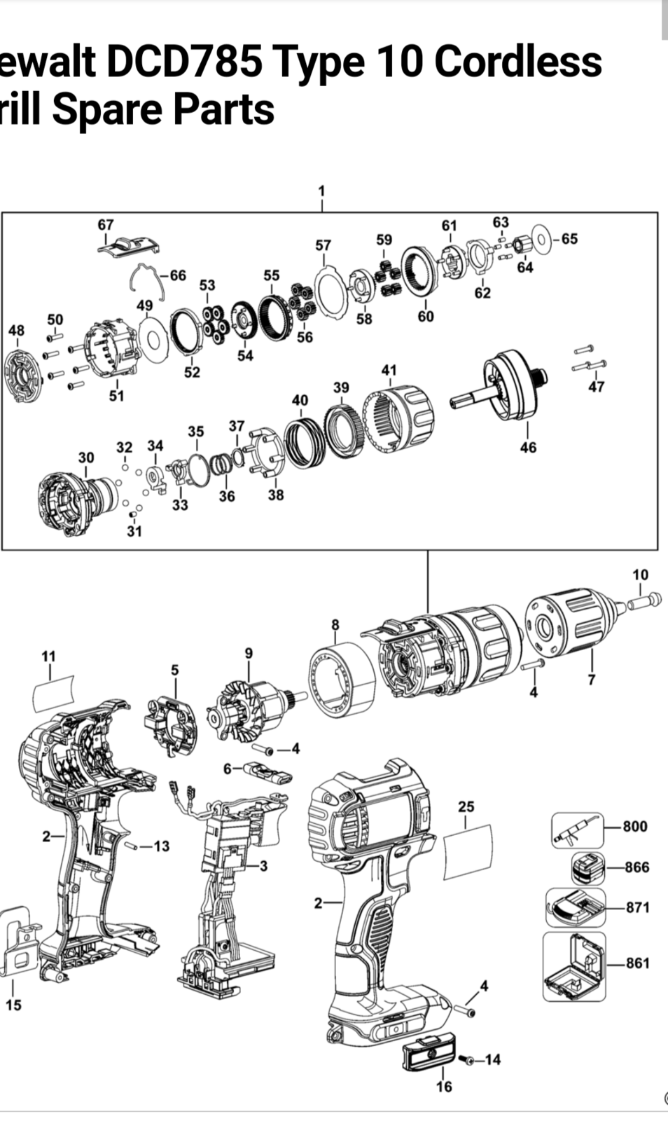

I wondered if anyone would be kind enough to help me please ? I have the above drill but have encountered a problem. The collar that allows changing between different torque settings is working fine but with one exception. I have found that I can no longer turn it to the position where the hammer option is engaged.
I have tried turning it both ways to no effect, and in fact if I try to turn it to the hammer position whilst operating the drill I can just feel a slight hammering action. It feels as if it is trying to engage the gearing (or whatever the hammer action is) but if I let go of the collar thre is no hammer noise. Might this mean that a good clean inside is needed ?
I have looked on YouTube but can't find anything relevant. I think I could get the chuck off, I am certain that it is a T20 headed screw inside there and YouTube videos tell me that it is a LH thread. I am tempted to start a dismantle but everything else about the drill is working fine and I don't want to do anything that will mean that I have to go and buy a new drill.
Any help and/or advice would be much appreciated. Thank you.

Thank you Gentlemen for your quick replies. Really appreciated. I wondered if it might be brick dust or something like that that's got in there but I haven't used the hammer part of the drill very often. I have an airline in the workshop, I'll give it a blast with that and report back. Is there any point in flooding it with WD40 or would that make it worse. Presumably even when I've got the chuck off there is still a gearbox of some sort to deal with ?
Could try wd 40 but that don't last. It dries up vs lithium grease
Thanks again for your help and advice. But can we get one thing clear before I "meddle" Is the "gearbox" (if that's what it's called) all part of the chuck. i.e. If I take the chuck off is that also the bit that holds all the bits and pieces that make up the torque options and the hammer option ?
A while ago but I replaced the entire gearbox assembly on my 996 and I'm pretty sure it all comes off from the "other" end ie you don't need to remove the chuck:

MMTC or there's a place in Liverpool for parts. It won't be the gearbox on yours. Could well be just the selector jammed - the diagram looks a bit scary because it's exploded - they do come apart in bigger lumps than that if you feel brave!
Thank you very much for that. ! I gave it all a good blow out with the airline but it hasn't fixed it. I must admit it does just feel like something is jammed. Suddenly I feel brave. :cool: I'll have another look on YouTube if you think it should be dismantled from the rear. Could you elaborate on "MMTC" please ? I just Googled it but couldn't find anything relevant. Thank you again.
