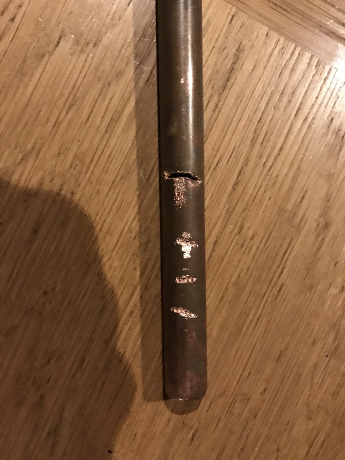

I just clamped a piece of 15mm copper pipe and put a new erbauer metal cutting blade on and this was the result after putting all my strength into it:
Absolutely useless!
Let's hope Dewalt will honour their 3-year warranty.
is the blade correctly fitted as those indents look far wider than the blade is thick ??
yep the blades slot in nicely and firmly a sense per the manual
