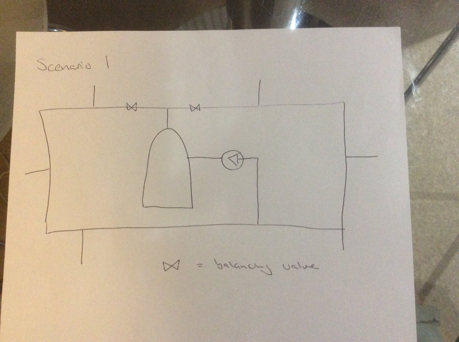

Scenario 1
I need to install SC in a large new build. The unvented cylinder will be in the middle of the house and so I would like to have two SC ‘loops’ i.e. T off the hot from the cylinder and go to each end of the house. Then install 2 return legs and common them before a single pump as it returns into the cylinder. In this approach I anticipate having to add valve to balance each of the loops so the pump is pulling both legs equally and not favouring any particular loop.

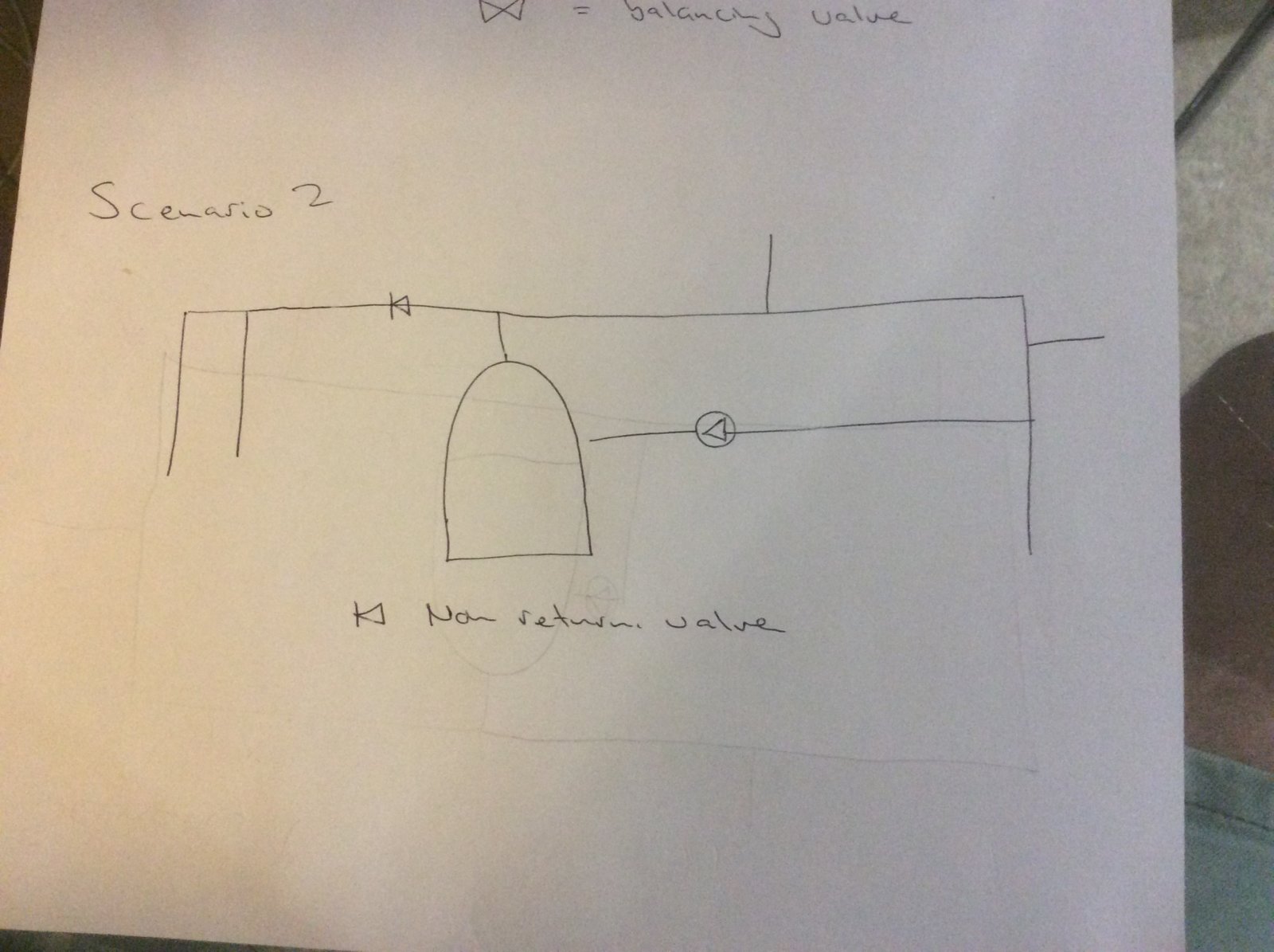

Scenario 2
Can I have some outlets off the secondary return loops and some low use hot taps not? So, I would again T off the top of the cylinder and create a SC loop with one of the branches of that T and take the other branch take straight to a HW tap(s) without a return?
If this is possible, would I have to have a one way valve to the none SC leg to prevent the true SC loop pulling on it?

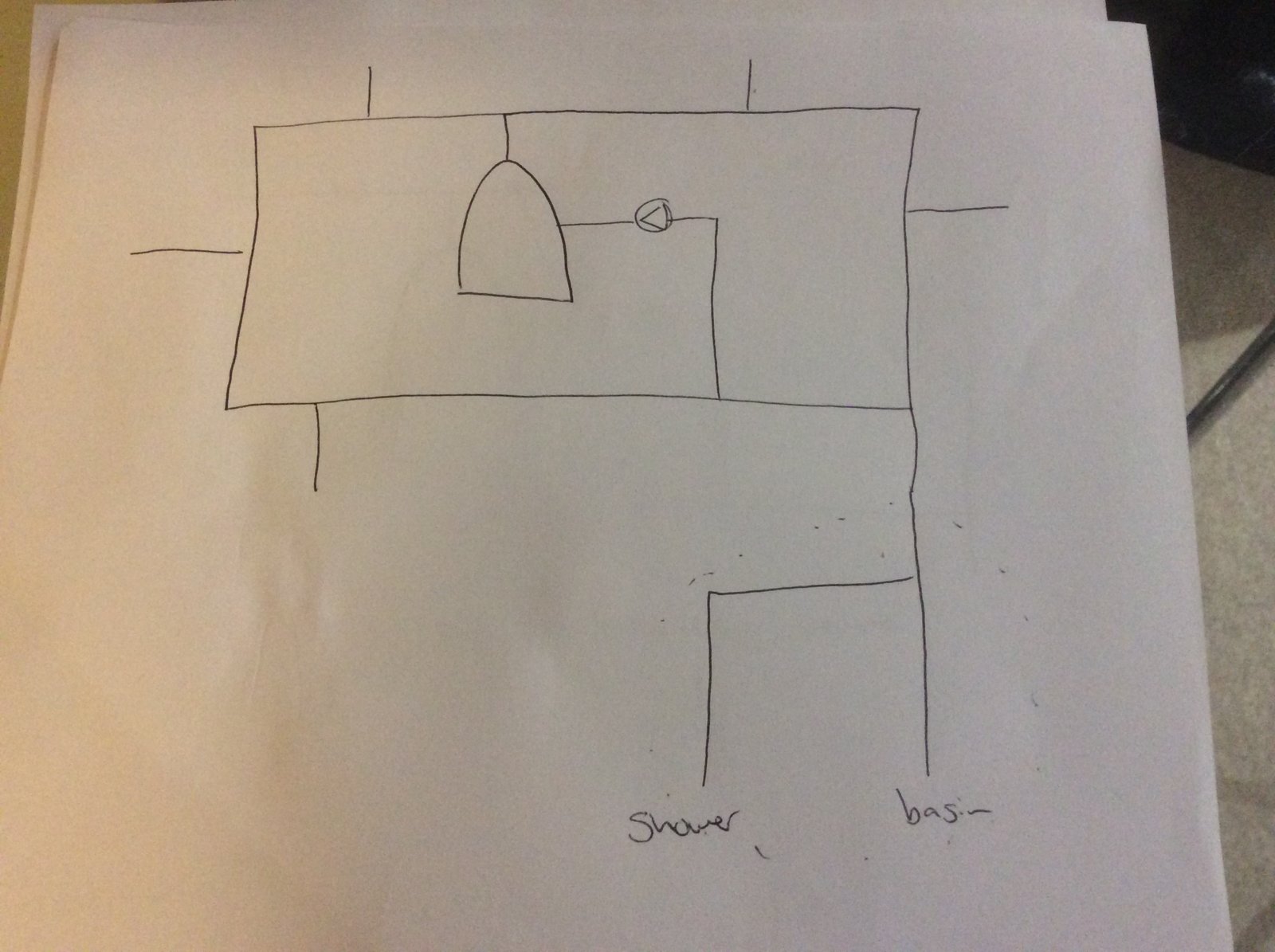

Can spur off the SC loop and then spur off that spur again. I.e. T off the SC loop to feed the shower and the basin with only one pipe.
