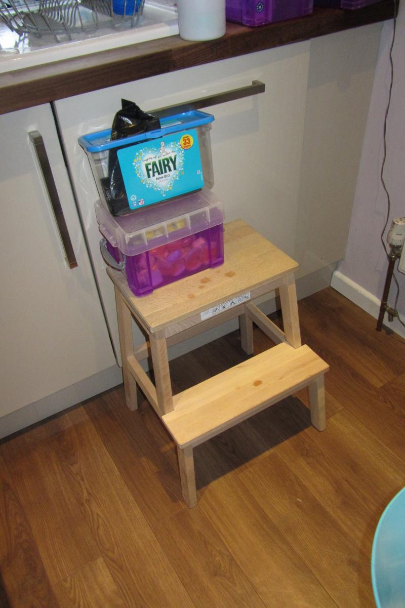

I rigged this up to hold the door shut;
After running for a little while, it stopped again. I removed the bodge and the door popped open and wouldn't reclose. What's it doing now?
