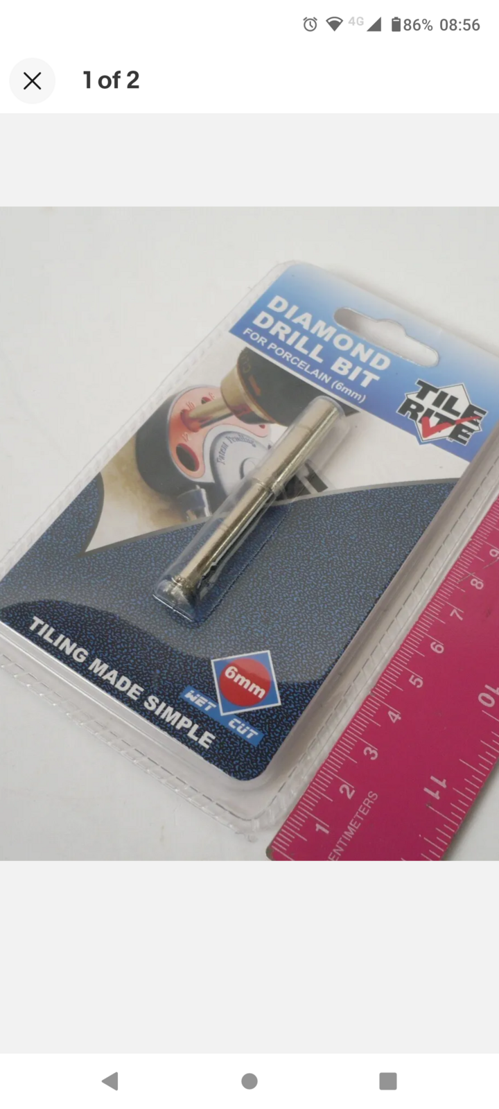

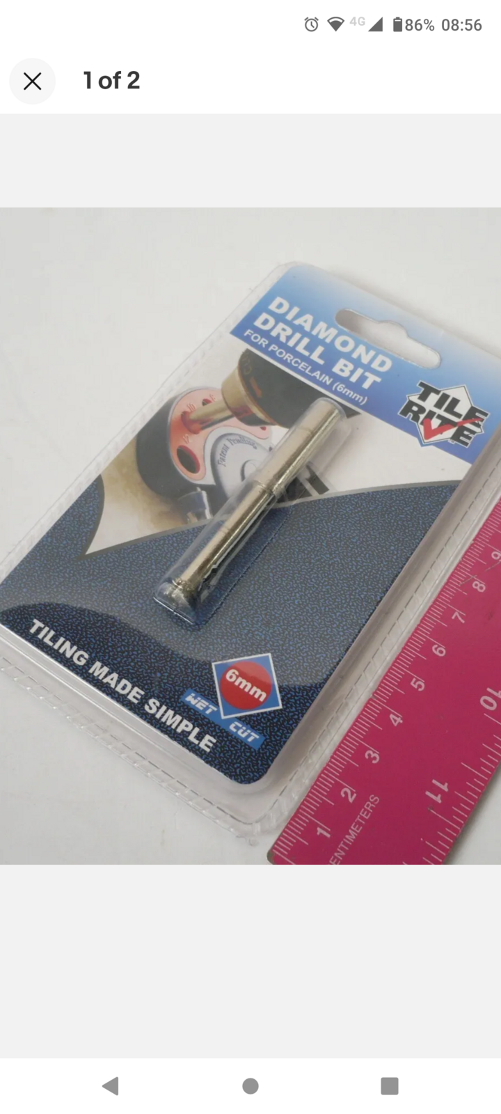

Well, before I read how much I should be paying for a diamond bit, I bought this on eBay for £5:
It managed (with water cooling) precisely one hole before it was gone.

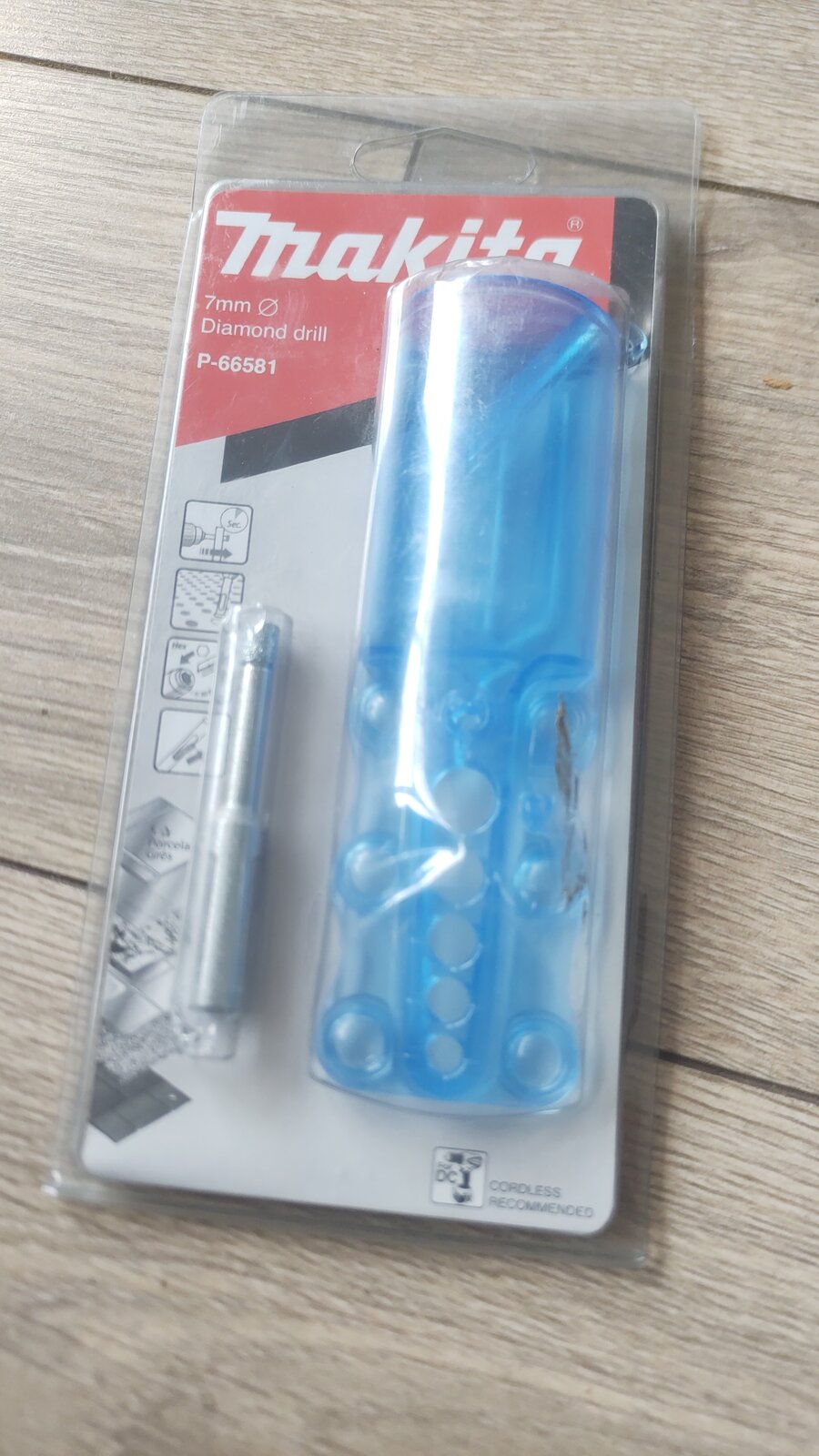

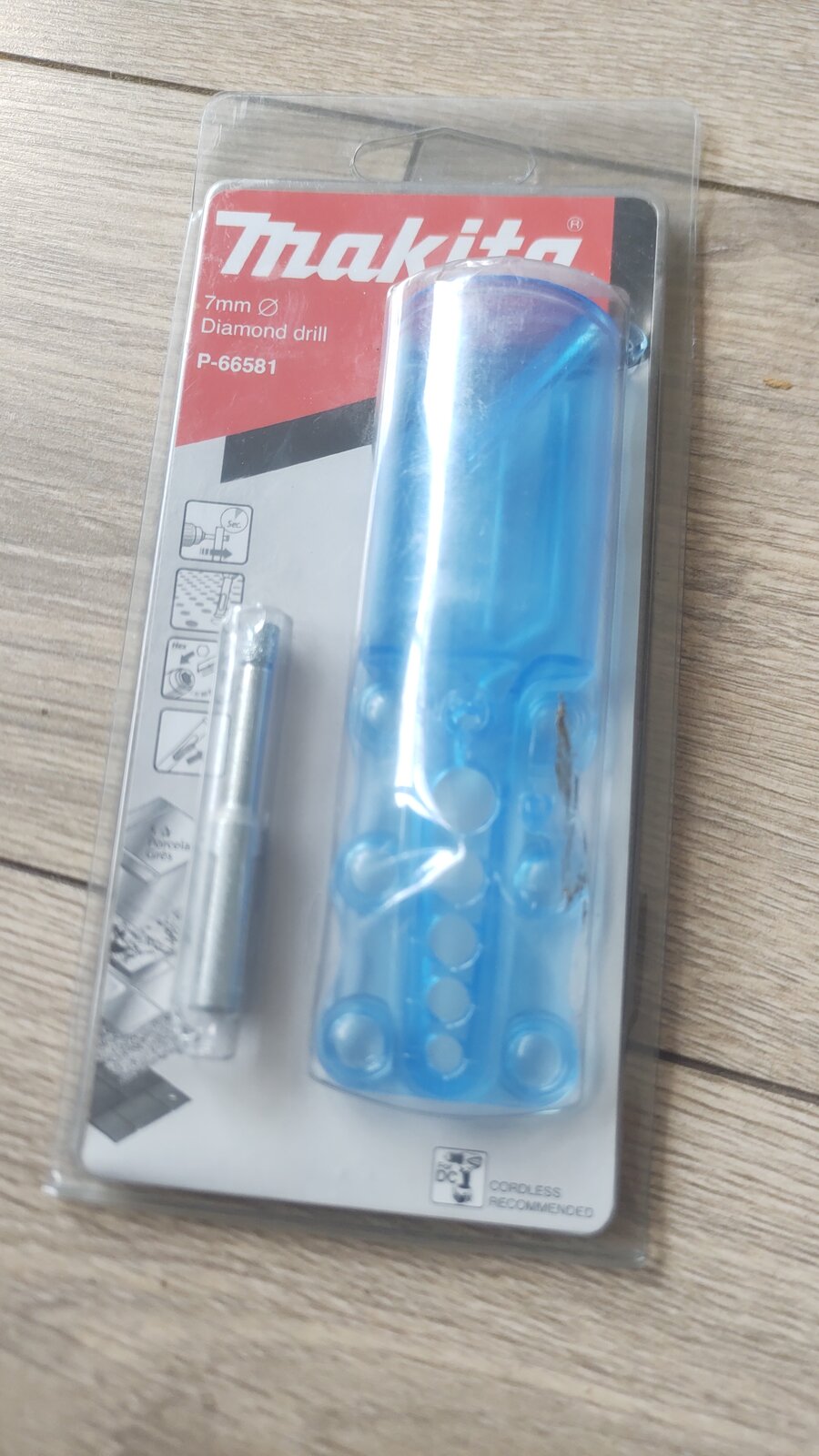

I have used the Makita one. The water is supposed to dribble down the wall from the reservoir above. That is the whole point of the reservoir (to keep the drill bit wet). To be fair, the holes make it easier to align the bit.
Overall, I was not impressed with it or the quality of the bit.
