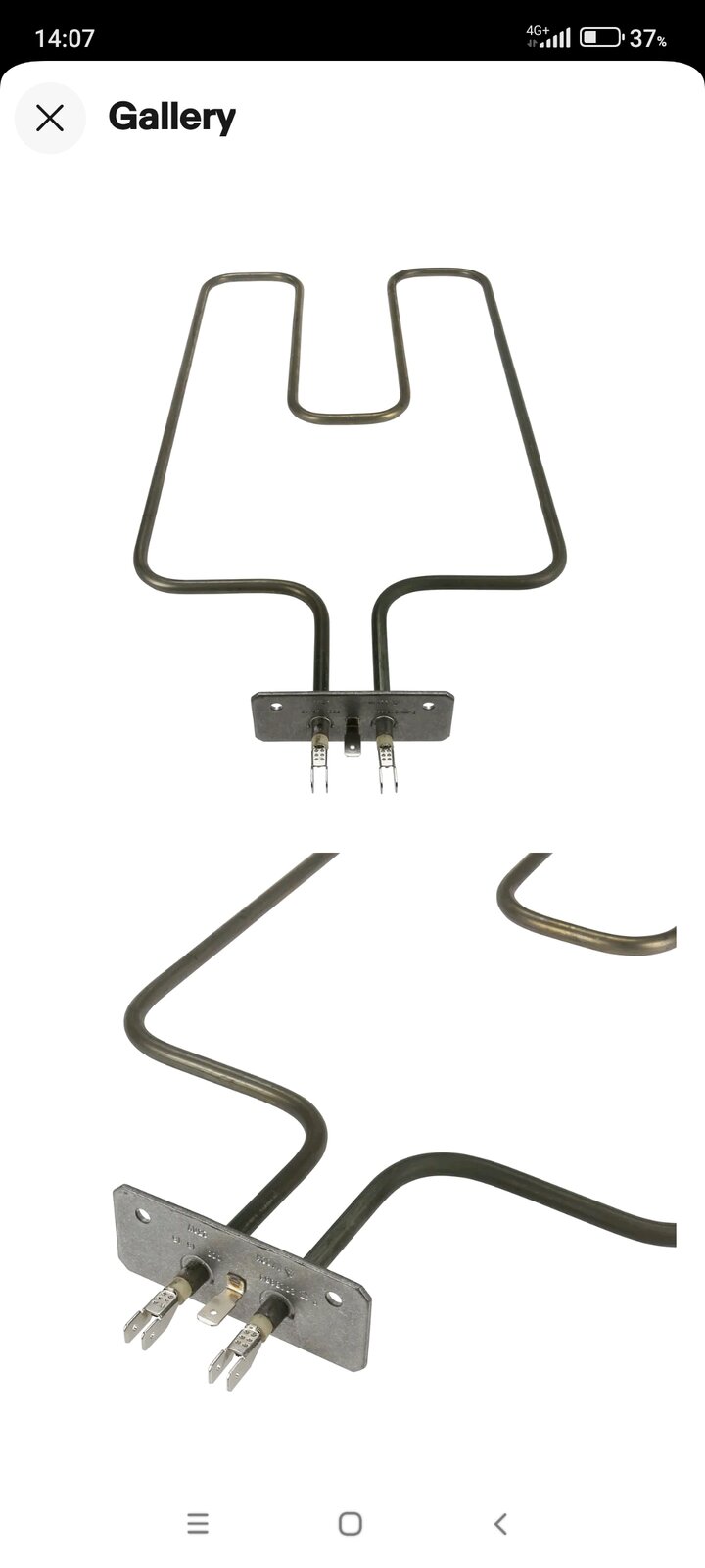

Good afternoon,
I have an old Beko 502W oven and I need to change a bottom oven element as the original one had blown. I ordered one online as it said it was combatable with my model. On receiving new element the spade connections are not the same. The original had 2 double spade connections, and the 2 wires were connected to the right side of both connections. The new element has 1 double & 1 single spade connection. I was wondering if it would be still ok to fit by fitting 1 wire to the single connector & the other wire to the right side of the other connection. The new element is exact same size (length, width, fixing plate) and wattage 1100w.
Any help on this would be much appreciated, thank you.
Regards Enrique
Yes! Providing the two wires, which were on one end of the element, end up together on the new element.
