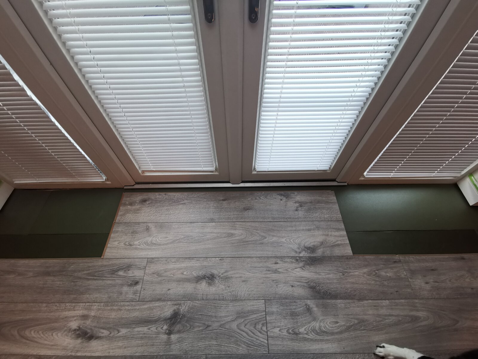

Can anybody please offer some advice on this issue?
I will try and post a picture below.
I'm having problems finishing Laminate flooring at an aluminium door threshold of a set of French Doors (double doors with a side panel of glass on each side) , think it's an old door, and the aluminium threshold protrudes into the room but only at the doors not the glass's side panels.
How would you suggest finishing it to get the best look?
Any advice appreciated as I'm totally lost at this point....
P. S Those two panels have just bee a placed there next to each other to see how I can finish off.

Remove threshold and replace with pvc.
Or leave threshold there and trim the planks.
In any case the side windows will need pvc quadrants to hide the gap.

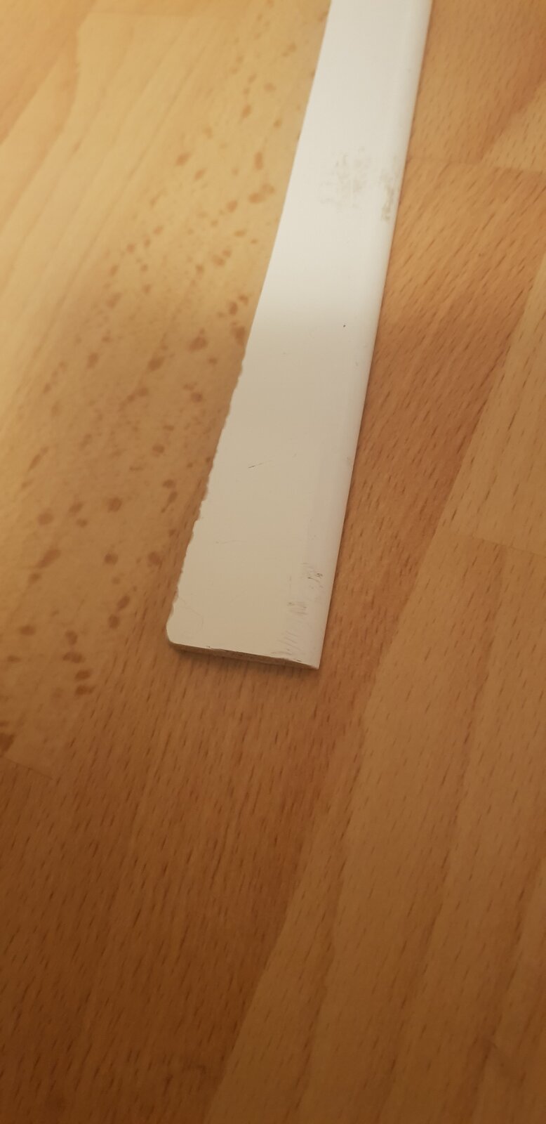

Then use a pvc flat trim.
Just to get you the idea, I have this bit in the picture lying about, but they do wider ones, so buy the one you need.
For the sides you better off with quadrant.

Don't try cutting the the alu trim it's a storm bar fitted to underside of frame so bad advise
Oops!
This is correct, i hadn't seen the picture close up and assumed it was just a threshold.
Don't cut it.
Lay the laminate under it as it looks like there's a gap, just under, so there's still an expansion gap.
Thanks guys so what's my options as the laminate won't fit under the aluminium trim?
Can I remove it and replace with something that finishes flat inline with the side upvc frames?
Or if not then what else can I do to finish off the laminate?
Really do appreciate your help guys.
I would get the laminate down and then find a trim to fit between the laminate and metal threshold.
sounds a good idea to get it down first then see what you can or cant get under the door, you might end up with a flat timber trim you profile under or up against the threshold depending what looks better once its done.

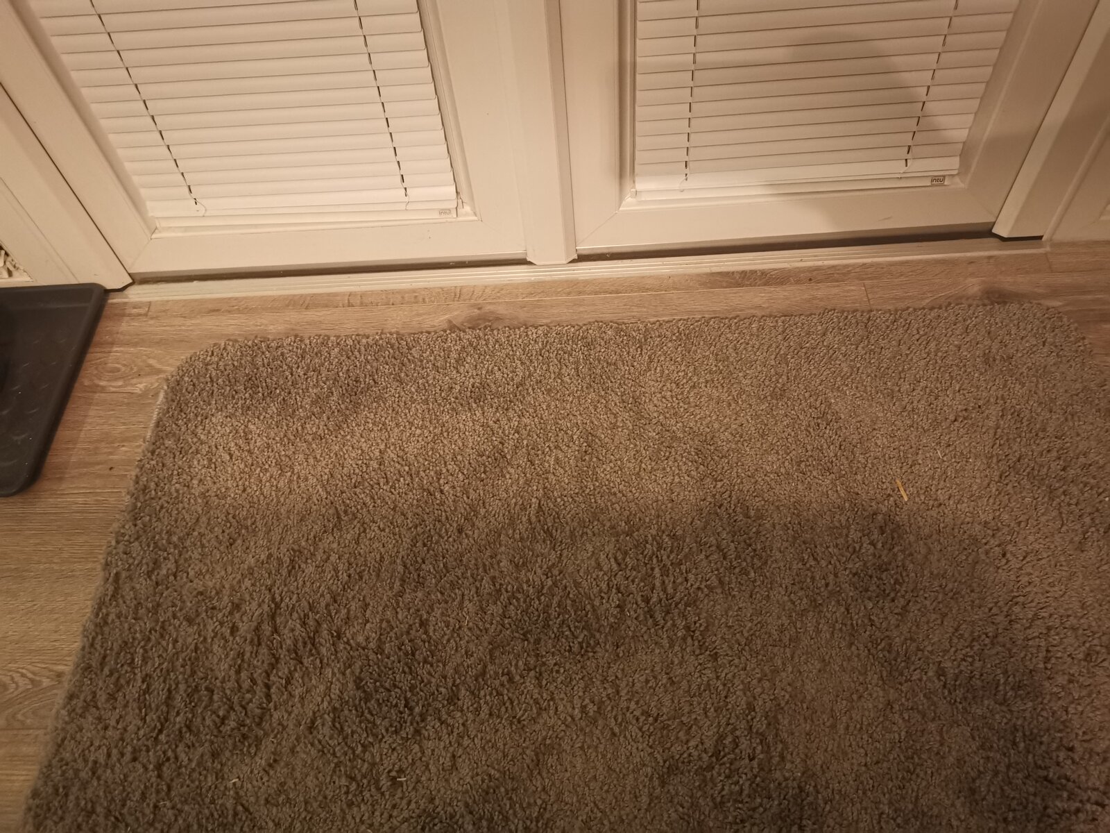

Hi mate I feel your pain, I was driving myself crazy trying to think of a solution to the problem. In the end I spoke to a couple of laminate flooring installers and double glaze doors installers and they both said to cut it with the required expansion gap and fill it with sealant. I questioned the expansion gap should not have anything in it as it's for expansion and they all said providing you've left enough room around the rest of the room that one bit isn't going to cause any problems.
I therefore did as they said and got some coloured sealant to match the flooring and threshold the best I could and im
well happy with the finish. It actually looks better in real life than in the picture, it notices more in the photo lol than it does in reality.
And there isn't any movement in my flooring therefore it doesn't break the sealant or move, however there was movement in the flooring I took up before I laid my new flooring, as the previous people installed 2 x 5mm underlay boards which created too much give under the flooring, are you sure your fitter hasn't done that?? My new flooring is also 12mm thick boards which may help....
