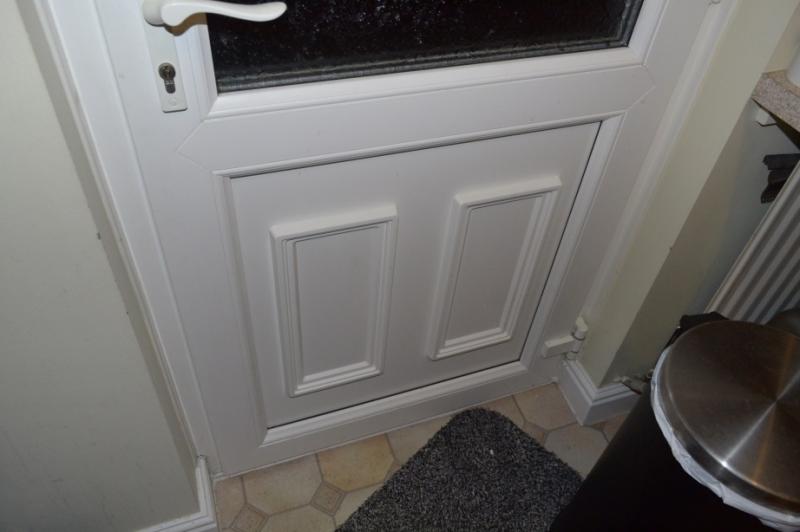

Hi, thanks for reading.
I've removed a upvc panel from a door previously to replace, but I'm having a lot of trouble getting this one out.
I've done a search and found a similar looking post, but it doesn't have pictures so I'm unsure whether it really is the same. The door is heavy so it might be metal require disassembly but I don't know how to tell whether it is.

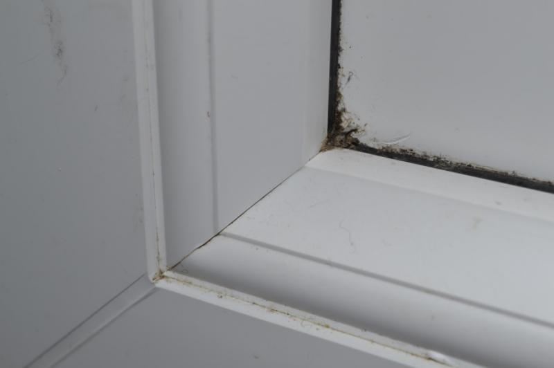

Trying to lever the middle of the beading just chews up the very small lip, and there is a hard gasket behind the beading which doesn't want to come out.
I've attached a couple of pics and any advice is greatly appreciated.

Juat wondering any chance the door has been fitted back to front and the removable bead is on the outside?
The beads are mitred in the corners so are impossible to release as one bead fouls the other, start in the centre with a sharp stiff scraper, thump or hammer it in and lever the bead inwards working towards the corners, once one bead is out the rest will follow, at this point you can start at the ends but not on the first bead.
The rubber incidentally stays in as it's part of the bead, it's what's called 'Co extruded'
No because the mitre on the bead would not be that tidy, it would of been a weld if the door was back to front that was cleaned off with a sharp implement like a Don Carlos,
I can only get a scraper/screwdriver in 2-3 mm then i hit another surface of the bead at a right angle so hammering doesn't help.
I can't get enough leverage to move the bead before the plastic is chewed up.
Use 2 or 3 progressively thicker scrapers (good stiff ones) all at the same time. 2 people working together would help.
Some beads are just a pain in the ass
knock the scraper in till it opens the gap, then tilt the scraper so the handle points away from the panel, then keep tapping so the bead is being knocked out of the profile
Is there any wedge pushed in on the outside of the door you can remove to loosen the beads??
