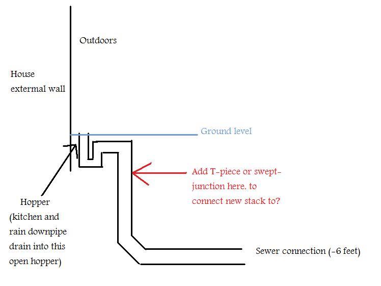

There are also two hopper/gullies (with trap) into which the sink, basin, bath, shower etc drain into. They are both underneath windows, so I couldn't run a stack straight down... this would effectively mean 2 right angle bends between stack and sewer. I could put rodding points into the stack, would that make such an arrangement compliant with the regs?
Can I add a T-piece onto the pipe below ground, below the current gully connection, then connect the stack to this? I have a combined foul/rain system, by the way.
This is the sort of thing I mean:
Can I add a T-piece/swept junction below the hopper connection? The hopper definitely has a trap as I can see the water level a few inches below the grating.

Be very surprised if all the pipes are 6' deep! Nobody does that amount of digging, even with a machine, unless absolutely necessary! Finding that manhole might be a good point to start, it may be under concrete (muppets :rolleyes: ), but one day you may need to get to it!
It may be that the pipes run at an angle from the surface to the sewer. If this does prove to be the case then you may be able to locate a suitable point to connect nearer ground level. (My house is 1896 vintage, the drains from the original W.C. and gulley ran almost at 45deg down to the sewer.) I dug back to suitable point, cut the pipe, fitted a coupling, and then a suitable bend to bring the pipe to (almost) horizontal. Immediately after the bend fitted a small chamber, then laid new drain from there to new gulley and stack postions. Indoor connection unlikely to be feasible (or legal!), you'd need the stack to rise from the drain, bends in wet section are not allowed!
I'd look at the setup of the drainage in the neighbours properties. If all the houses were built at the same time, sharing the sewer then layout will be pretty similar, may give you some clues! If you feel energetic, dig out from a gulley, expose the pipework and see where it goes. Check with B.C.O. though before making any connections.
