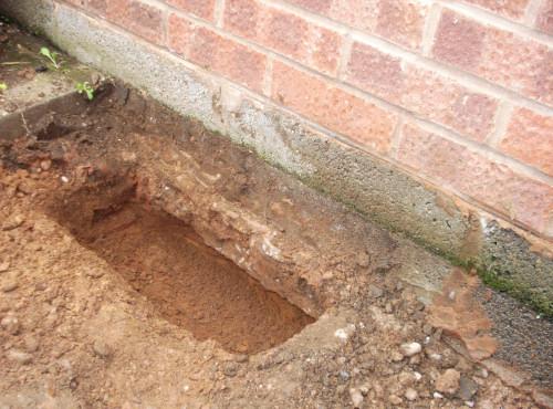

Ok, I hope the image works. This shows where we dug at the rear of the extension. There is approx a 6inch concrete footing with the 8inch block on it then the brickwork starts. The DPM sits at the top of the block and thats roughly where the internal slab is. This was the only place hubby was able to dig to see how deep the concrete was as there was alot of concrete about 1ft out from the wall but not solid just appeared to be spilt over perhaps from the footing.
Hubby had a look in one of the manholes and now thinks the carport/garage may not have had a slab pre the extension as the bricks are only 2 courses high, raised from the original level which we think was likely tarmac. All the other bungalows in the street only have tarmac carports.
Does this help? Can you advise any further? You suggested that not having steel reinforcement was not that much of a problem, is this the case as we thought if we dug the chanel up to fix the pipe and found no steel reinforcement we were concerned that we would have to dig the entire slab out and start again but thats because we are going on Aust regs.
Belinda
We're only dealing with a garage floor here Belinda. I'm pretty sure that there are no requirements for reinforcement in the floor but I'm sure someone will correct me on that if i'm wrong. The picture and what you describe strengthen my initial thoughts that it was installed after the foundations and is a separate slab. You've really got to start and dig it up and see what you've got. As it's only a garage floor why not just patch repair the concrete once the job is done.
