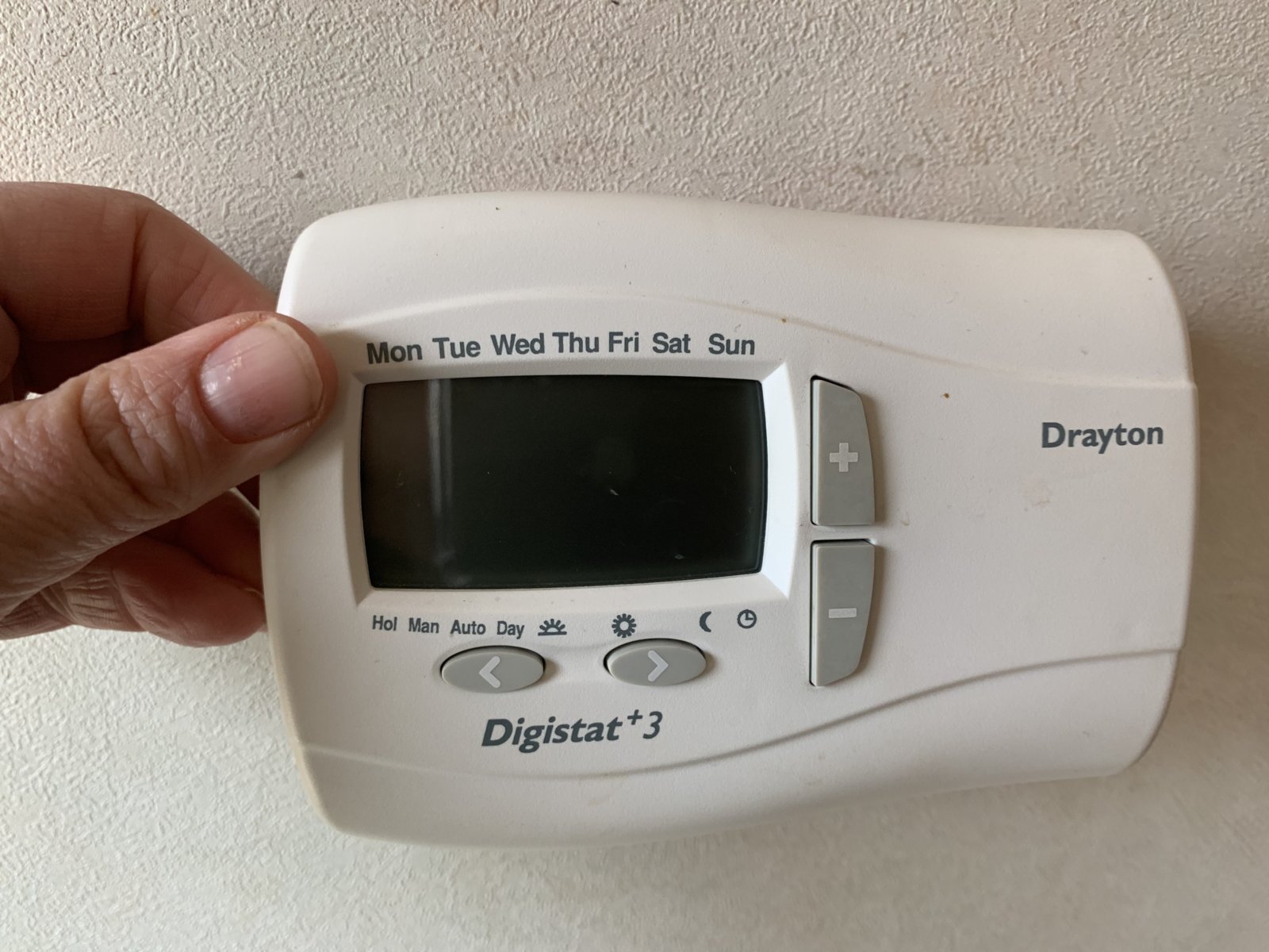

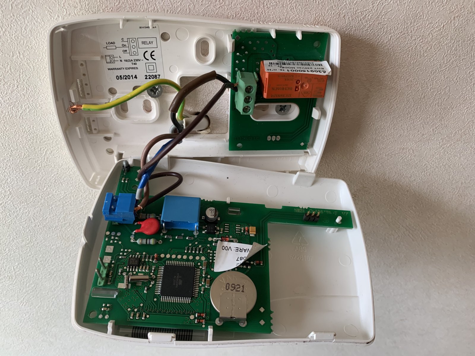

Hi
I’ll do my best to explain the issue but I’m far from knowledgeable and hope someone may be able to help with this (y)
I have a digistat + 3 thermostat in a static caravan
the screen has gone off, meaning I can’t control the heating
Having looked on google, a few people have suggested changing the 2 x AA batteries but mine doesn’t have AA batteries, it never has as far as I know (I’m the only person living in the van and have temporarily moved out, when I nipped back to check on it the screen was off)
I also don’t think it needs an earth wire looking at the manual?
sorry if I’m being thick! Help appreciated (photos attached if they help)
thanks

Need to test if it’s getting voltage if it’s getting 240 v and no display its goosed,if no voltage then it’s a supply problem to the stat
what boiler do you have ? is it switched on with all lights on ?
Yeah boiler is on looks fine, lights up as expected. I stupidly didn’t check to see if I had hot water when it was on so I’ll check that next time I visit the van!
I’ve also read the c2032 battery is soldered on and that’s used for memory, would that also power the screen? I’ll test the battery when I next go down I only had 5 minutes today to look at it unfortunately!
