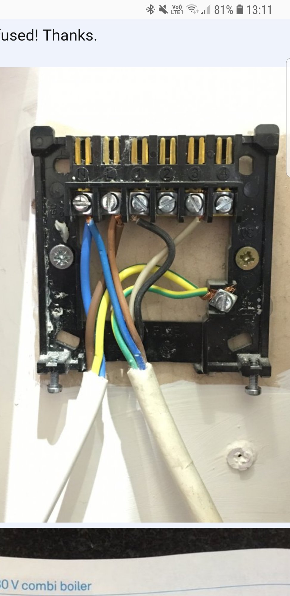

Hello all
I'm replacing my old digistat SC1 with a Salus RF500
My current set up is this with a 5 core and 3 core

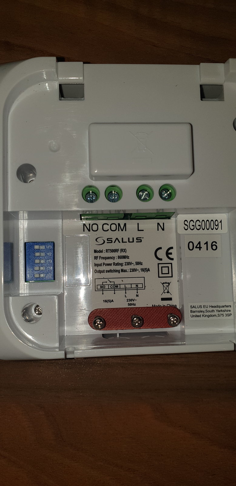

And I need to put the wires into this
I gather the 2 earths should be boxes off.
2 Neutrals into N
2 lives into L
But then what do I do with the 2 spare wires from the 5 core? I gather one goes into NO
Also, do I then have to add another wire to connect COM to L?
Thanks in advance for the help!
black wire and grey wire between NO and COM doesnt matter which way round it is just a switch, why do you have 2 lives and 2 neutrals ?
