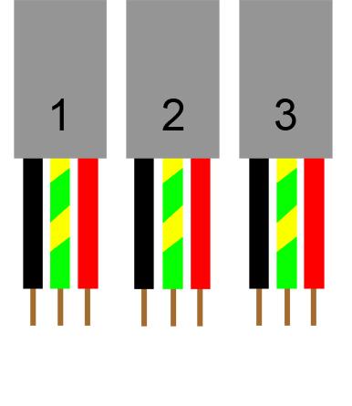

OK, apologies for the diagrams, but here's what I have.
I have 240V across Red 2 & Black 2
I get 240V from Red 2 to any Earth
I have 125V from Red 2 to both Red1 & Black 1.
I get nothing at all on the 3rd set of wires
At the switch, I have no voltage as the light fitting is not attached.
I will assume that the yellow & blue go to a secondary switch somewhere, but I don't have one, so they must be dead wires somewhere!
Does this help?
Thanks,

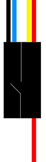

turn the power off, and switch the switch on ans see which red and black has continuity..
that's the switch cable..
then wire as follows..
View media item 13604
the left hand cable in my picture is the switch wire.
ColJack,
I was doing just that after I posted the wiring diagram, and have now sorted it. Simple schoolboy error of not making a note of which wires went where!!
As it was, Red2 & Black 2 were the live feed on the circuit, Red 3 & Black 3 are the switch circuit and Red 1 & Black 1 are the continuation to the next light. As such, I've now got them wired up correctly and all my lights are working again!
Thanks to you guys for the help, much appreciated.
