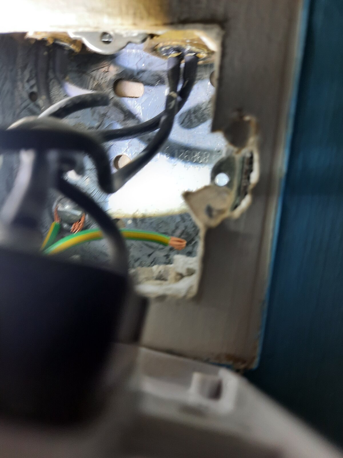

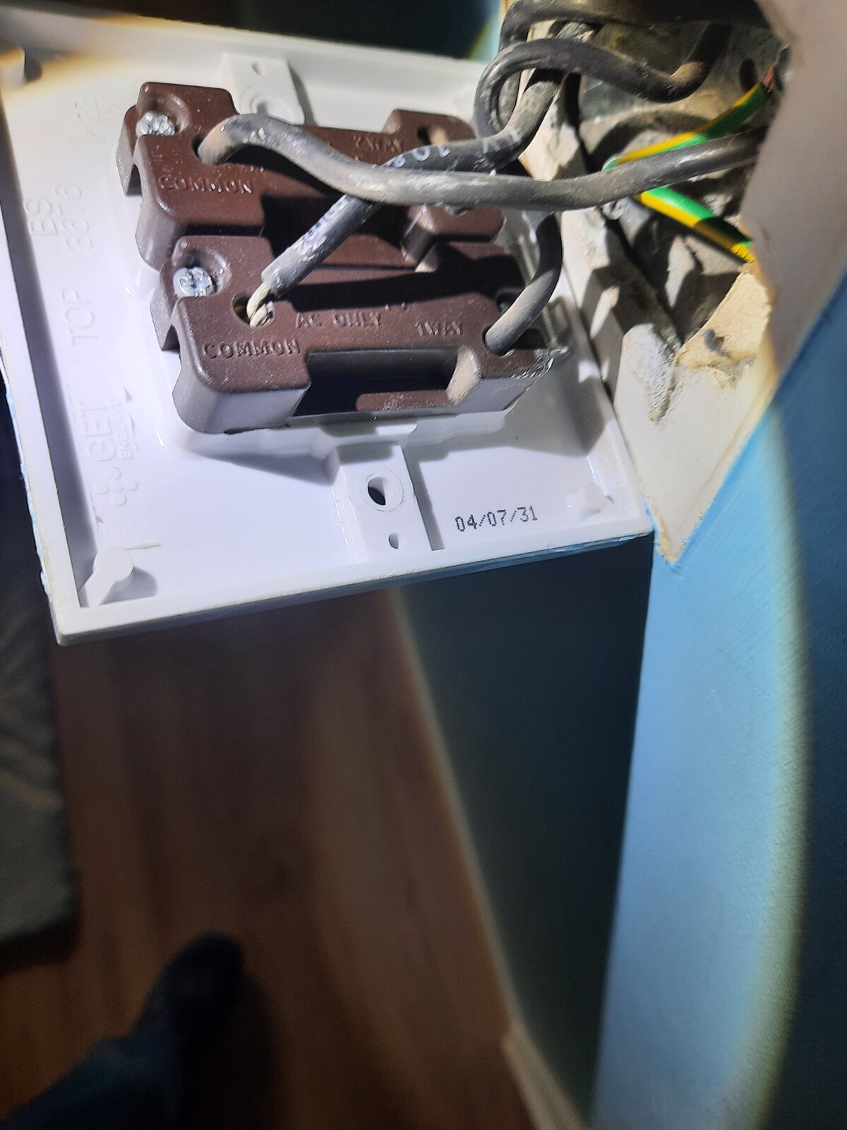

I'm replacing a 2 gang 1 way dimmer with a 2 gang 1 way dimmer and on/off switch but not sure how this would wire. I have 4 wires going into the old dimmer ,2 comms and 2 L1 but the new dimmer has 5 terminals with 3 terminals in the dimmer module and 2 in the smart switch can anyone enlighten me ? Thanks
The wire that is in COMMON on the old switch goes to the L. The wire in 1 way goes to L1.
Same for the other half. Dont mix the wires up.
Um. The new switch is a double width plate. Your old switch is a single width. How are you going to sort that?
The big question is are they all on the same circuit, i.e. does one circuit breaker turn off all?
I have a 4 gang switch, with two low voltage circuits, and one extra low voltage circuits, so am aware one can not always combine two circuits, the smart switch you have uses a single line feed, the old switch uses two line feeds, it may be they can be combined, but also combining could cause a borrowed neutral, which is both dangerous and will cause rcbo's to trip.
Firstly, yes i have to replace back box. Does it matter which wires 2 wires go to which module ?

Yes one breaker turns off all the lights ,it's a one bedroom flat.
