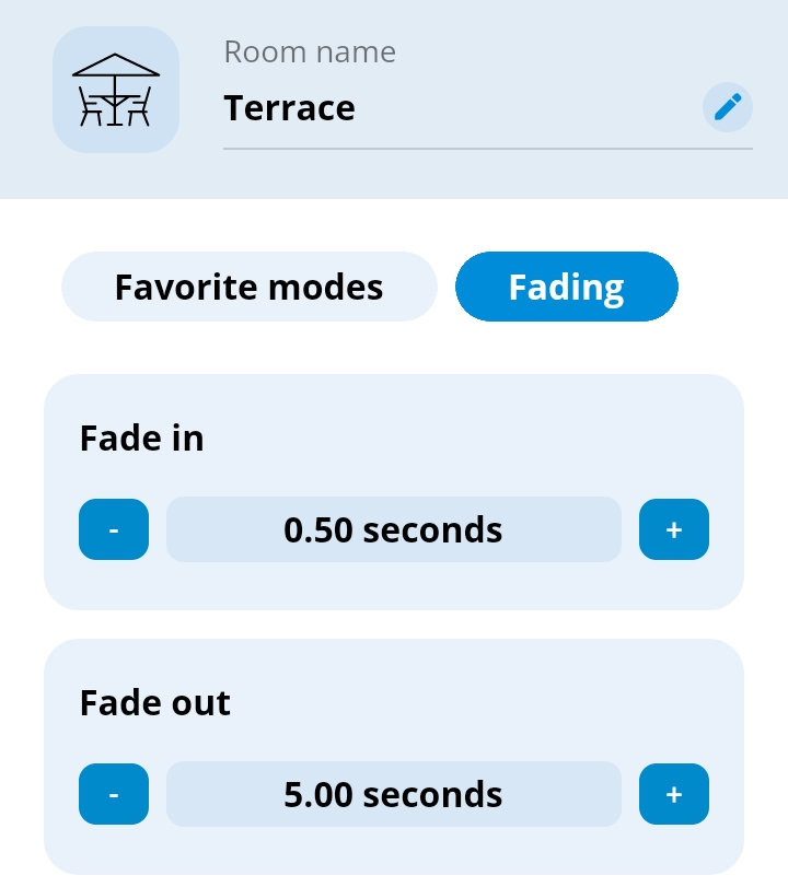

I have one odd light bulb with the fad in and out function. These can be set in the app 1724673577672.png I find it good so I have some warning before it switches off, however just looked at the app to get that screen shot, and I note there seems to be more functions to last time I used it. I turn on and off with Google Home or Google Mini, so had not opened Wiz app for some time.
I have looked at the instruction manual and I fail to see why called "Intelligent" but the instructions also boast 1724674555800.png so I would have said if it did not soft start it was faulty, it is doing what it says on the box.
