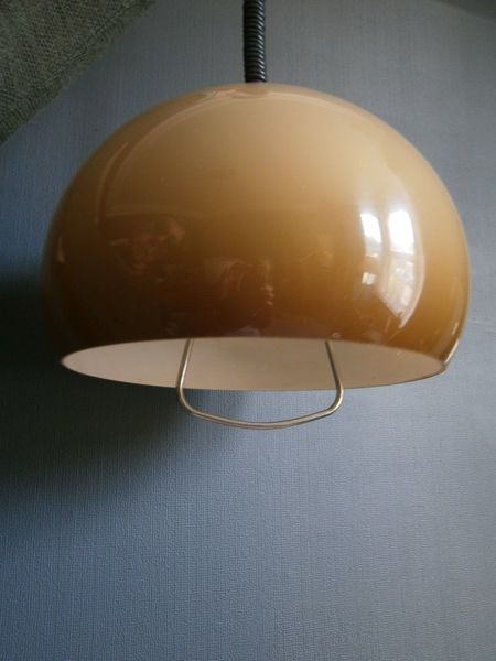

Just finished decorating our dining room and refitted the lamp similar to this
and the 100W bulb had become detatched from the B22 cap. Currently fitted a 60W but not bright enough.
Im looking for suggestion for suitable replacement and dimmer to go with it. I've encountered some aweful combinations of flickering, virtually no dimming etc and wish to avoid a learning curve.

Thanks for the thought and yes I agree the built in dimmers are good.
It is adjusted on a very regular basis and by different people, the room also gets ocassionally used for office, TV, meetings. I really don't wish to add complication to it.
