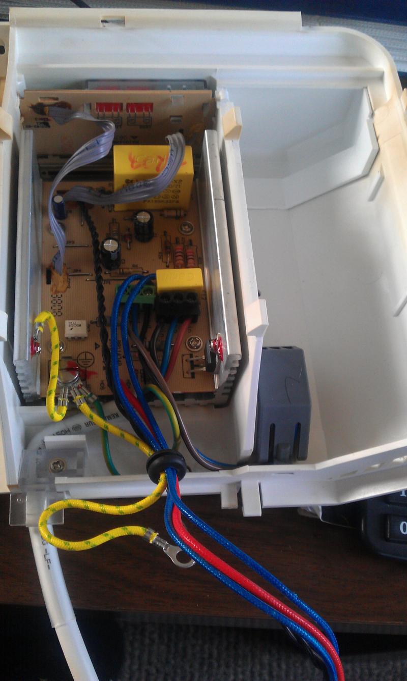

Hi,
My Dimplex EPX Panel Heater comes on when requested but is more like pulsating on off on off as it heats inluding the heat light.......
I know this is down to the electronic control panel px08014 but can anyone give there ideas to the part on the control that may be causing it.......
Capacitor, transistor, etc etc
Would rather change a part than the whole board at £60...

Hi,
2 photos below,
I can tell you that the output 220v live is the red wire between the 2 blue wires, it appears to be fed from the middle leg of the transistor BTA16-600B and is only live when thermostat is in heat mode, the other 2 outer legs seem to be live permanently, it is the center leg that is oscillating on the output many times a second, the other 2 legs are steady 220v.........
Not too sure if the transistor is at fault or the voltage to the transistor is at fault causing the transistor to oscillate!
Did read that this type of transistor may rely on a snubber capacitor etc to control the input side to the transistor, could there be a fault there?
Many thanks,

Hi, maybe a better word would be cycling on and off a few times a second.....this was apparent when the heater was complete, could even be noticed when watching the electric meter......
The yellow box is a capacitor....

Sorry if I come across as confusing.......Since stripped down I have been testing the board on the load side with a 60 watt bulb, it has been illuminating on and off at a rate of approx ONCE a second (not few times sorry for the error)........
I take on board what you say about the triac only switching with a load, I assume that the 60 watt standard bulb would be sufficient, the cycling on and off of the bulb does represent exactly how the heating element was reacting when complete......
I also am assuming that it could be problem prior to the optoisolator which works with the triac......I am a little suspicious that although the mains on neon/led is fine, the neon/led heat light also cycles on and off in line with the light bulb, and I did not think that the optoisolator or triac outputs had any relationship with the neon/led but was controlled prior to these 2 components.....
