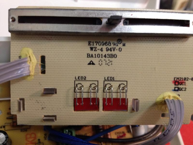

I have a couple of Dimplex EPX panel heaters which switch off after a few seconds. Sliding the thermostat knob makes no difference. Is it the thermostat board and can I get a replacement board?
The heaters are EPX 750 series C, and EPX 1500 series B, both were new in 2008. A new heater will cost around £120, so a repair would be good, especially as there are five others in the flat which may fail soon!
Below is a pic of the thermostat board. Any help would be appreciated.

Do you know what the yellow mastic type stuff is around the joint into the board?

Thanks for that jj4091. I sprayed it with WD40 which made no difference unfortunately.
flameport - ok, won't use that again! I wiped the contacts with a rag to dry them and get rid of any dirt. I have just checked the slider with a multimeter and it seems ok - the resistance changes as the slider is moved.
