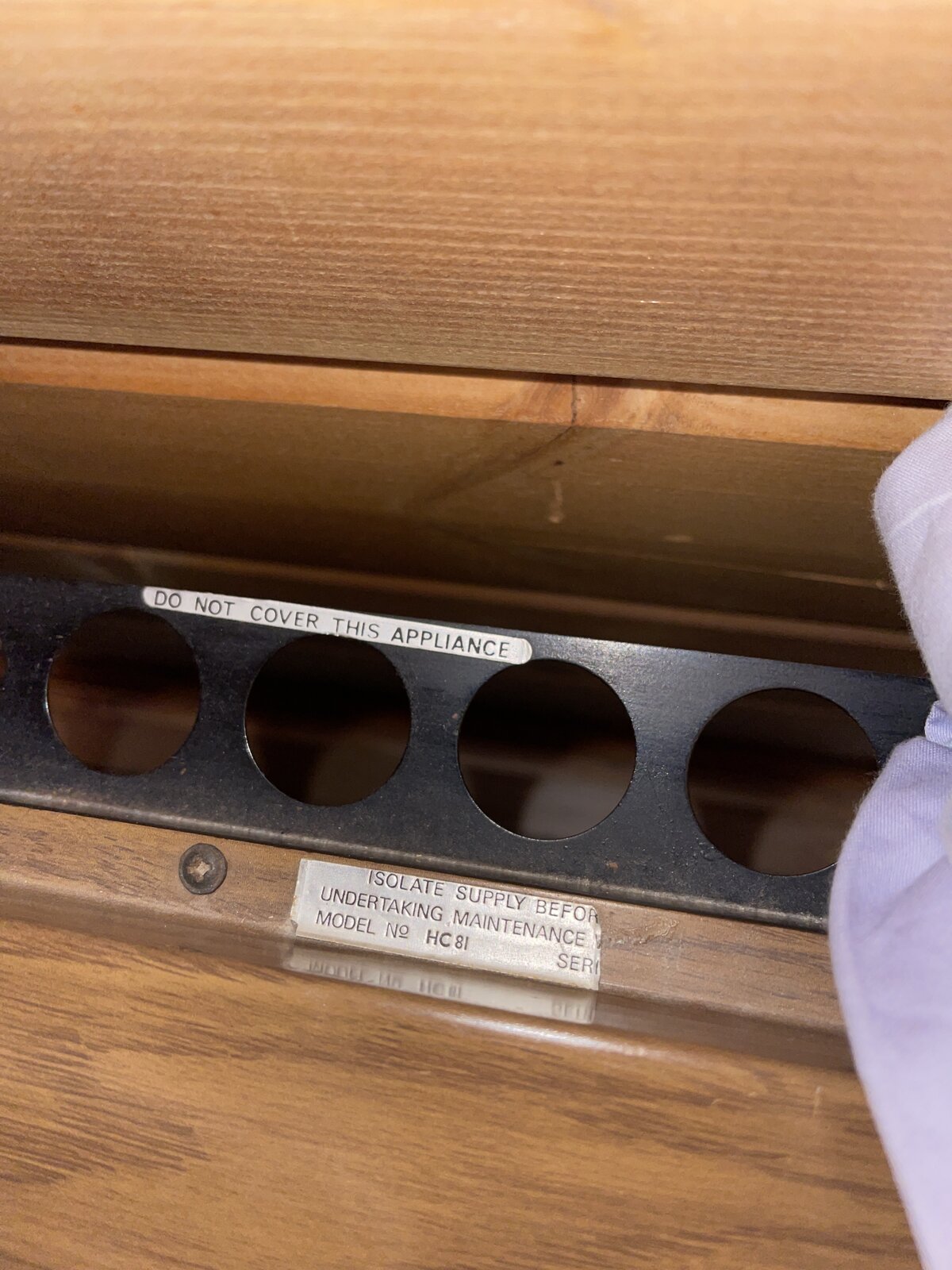

Hi all,
I've just bought an old house and it has this storage heater in the hall. It's part dismantled (bricks are gone), but there is still a layer of insulation.
I can't find a serial number on it anywhere. Can anyone recognise the model and whether it is an asbestos risk?
TIA
Thanks for the info. We bagged it out to the garage (mask, gloves, goggles). That was probably pretty stupid then. Will contact the council about disposing of it.

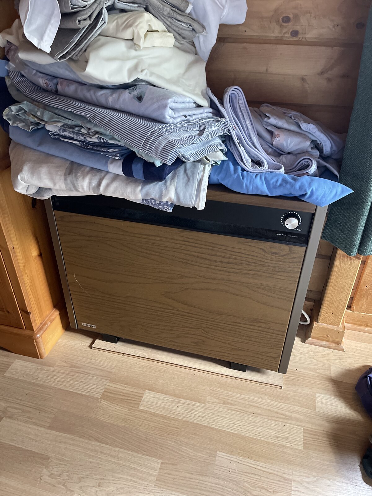

Hi @JobAndKnock, do not despair! I have three of these, the model no is HC81, which do not contain asbestos. Just in case you have been worrying for a year about doing damage to your lungs and for anyone else googling.
