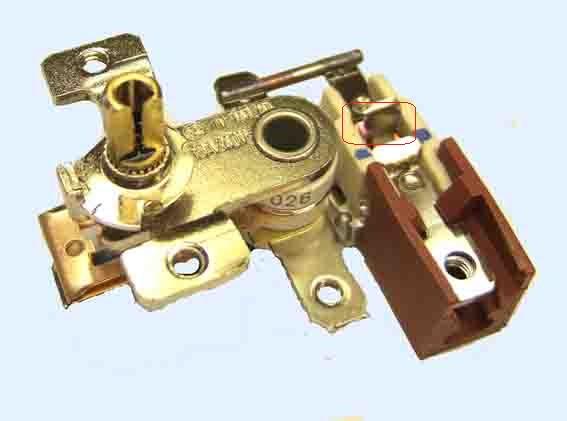

Our peak boost seems to work but off peak store doesn't seem to work. We have Dimplex CXL N. Old type.. Tried looking for any thermostat switch, after removing the cover. But couldn't find any.. Any advice please.. Would be very helpful
chances are the thermal cutout has tripped. There should be a reset on the thermal cutout module, the little bar just above the blue marks in the attached pic, this would be pressed towards the wall or down until it 'clicks'. Make sure the power is OFF when you do it.
attachment.php
If this doesn't work then it probably needs a service/new elements and you'll need a qualified spark to look at it.
Thanks and you are star with spot on. In your image, i have marked the standing plate which i tried pushing towards the wall but it wouldnt click or do anything, it just comes back to standing position.
hope i am doing it right or you would advice that i need a pro..
If the thermal cutout has tripped you should hear a click when pushing. If it hasn't then I'd be looking somewhere else.

Thanks all for your advice. Not sure how but it started working on its own! All i had tried was to try and move the thermo stat vertical rod towards the wall!
Moving the lever must have reset it, or certainly enough to re-seat the contact. I would have expected you to hear a click but possibly not if it hadn't tripped the contacts fully open.
