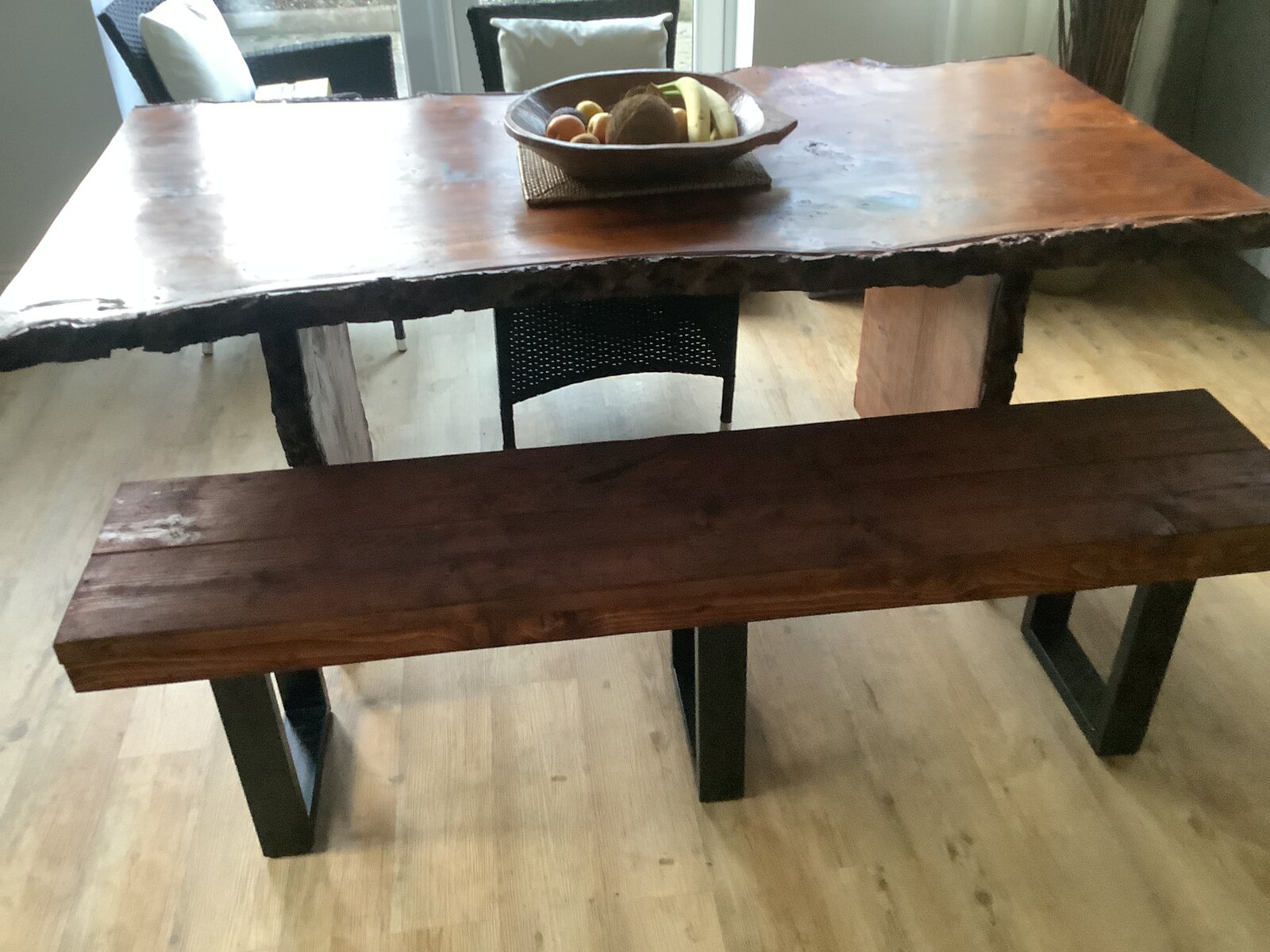

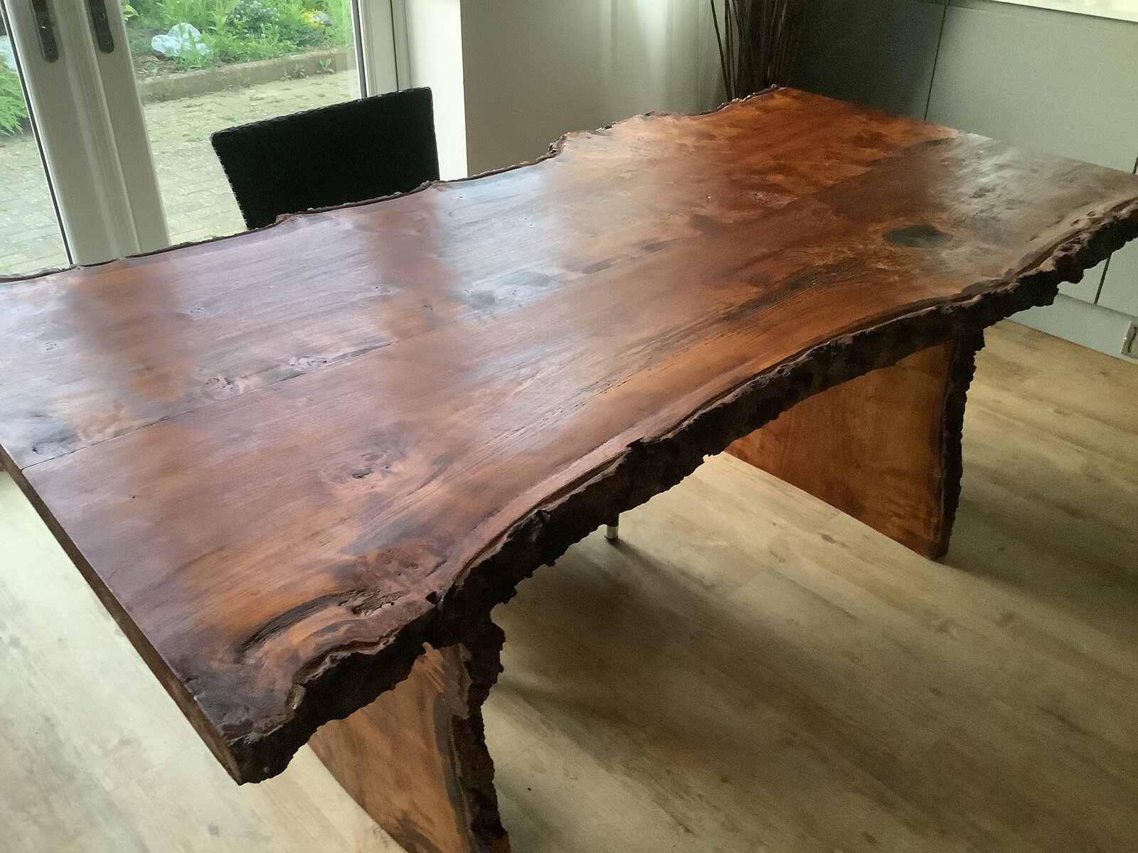

Dining table finished.
14 Mar 2006
23,139
3,361
Essex coast
Now to make seating

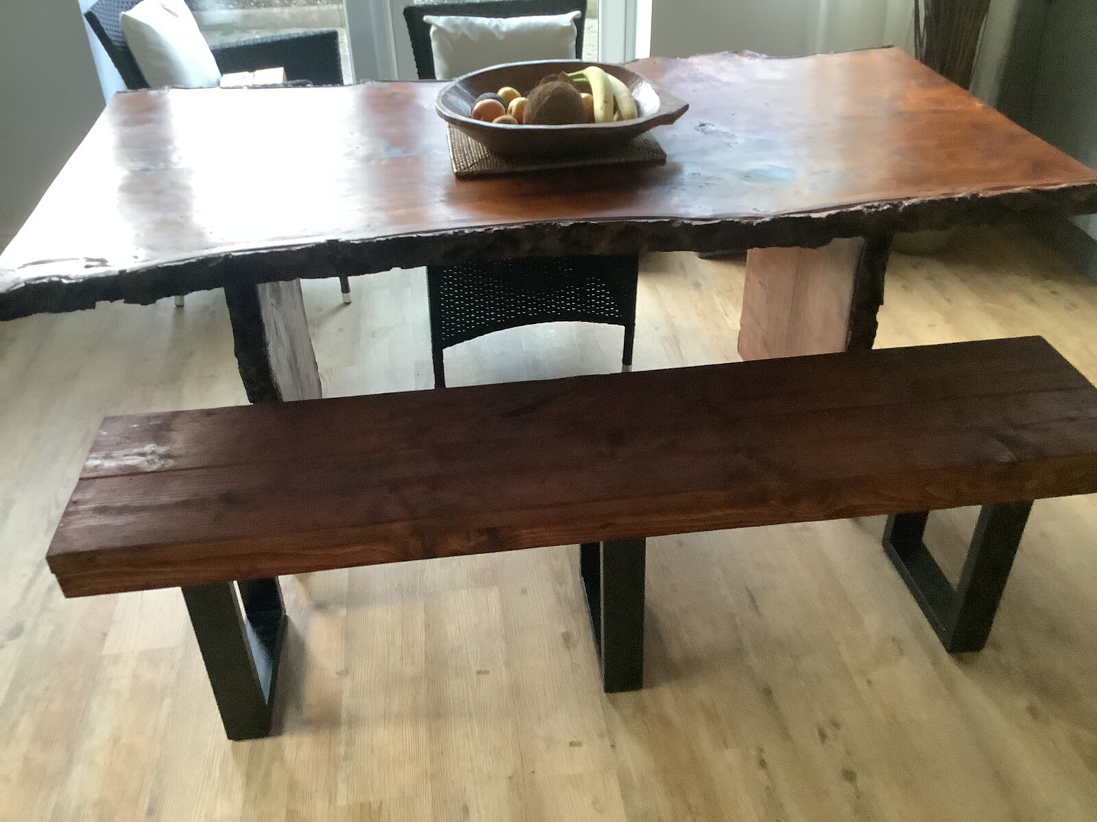

nice but how are you going to get the bark to stay on as I have found with things like that the bark falls off eventually
Has to be treated correctly, light brush , small gas torch to burn off any loose or flaking material , several generous coats oil .
In my experience usually falls off over time. Not going to affect the beauty of the piece if it does though

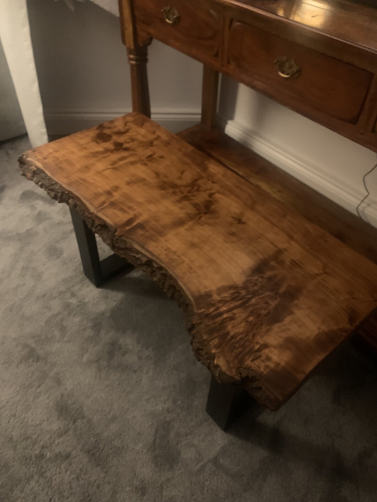

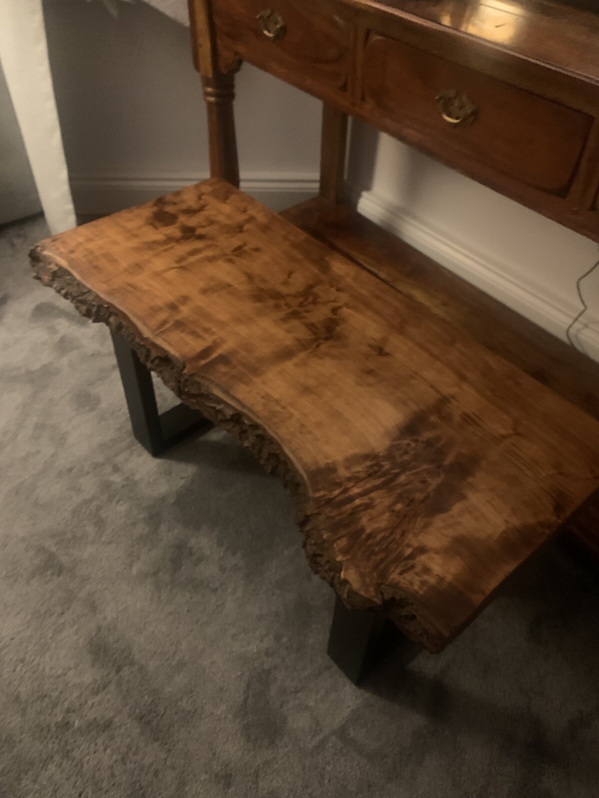

Offcut used for dressing table seat.
Very good work, Sir!
To prevent bark coming off, I spray it with hairspray several times before final finish.
A trick I learnt from my master many decades ago.
Do you give it a quick trim before applying the hairspray?
A brush off with steel brush, to get rid of loose bits, then a blast with compressed air, then hairspray, a few very thin coats.
