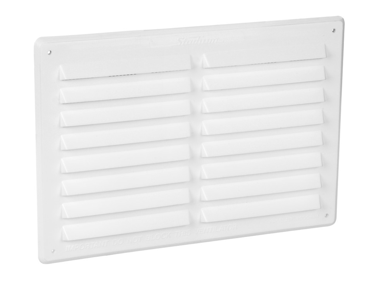

I have a air vent in a solid wall. It's approximately 1.6m up the wall.
With this type of vent, should the vents be facing upwards or downwards please? Also, what's the rationale behind the direction of the airflow.
Thanks in advance.
If they face downward, it will be easier to dust.
At high level, vents facing upwards avoids down draughts, and you don't see the vent gaps so looks better. It's the opposite at low level
