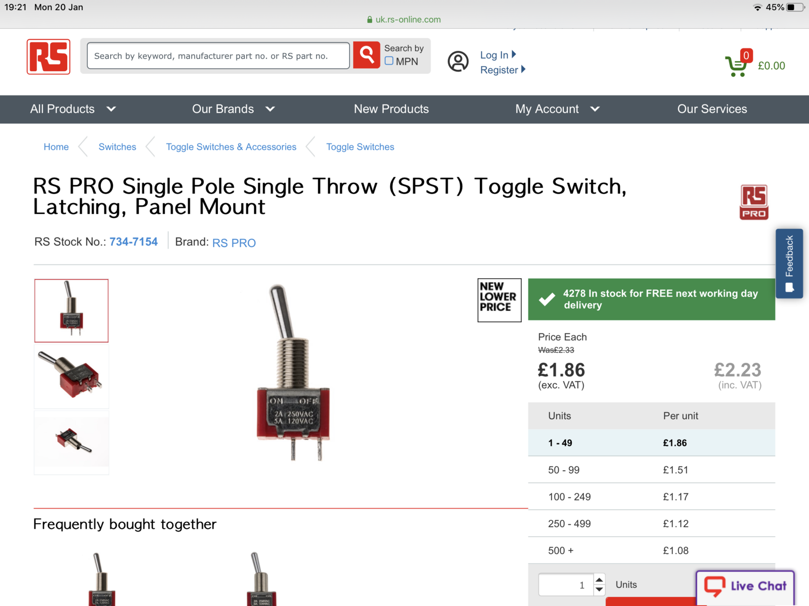

Drill hole 6mm on side of handset and fit toggle switch ....this is what I fit on the yc200 handset
This looks perfect and was just the sort of reply I was hoping for. So cheap too!
I am guessing that I wouldn't need to use that auxillary button for this? Should I bypass that and wire directly to the toggle switch and terminal 7 (Call) instead?
