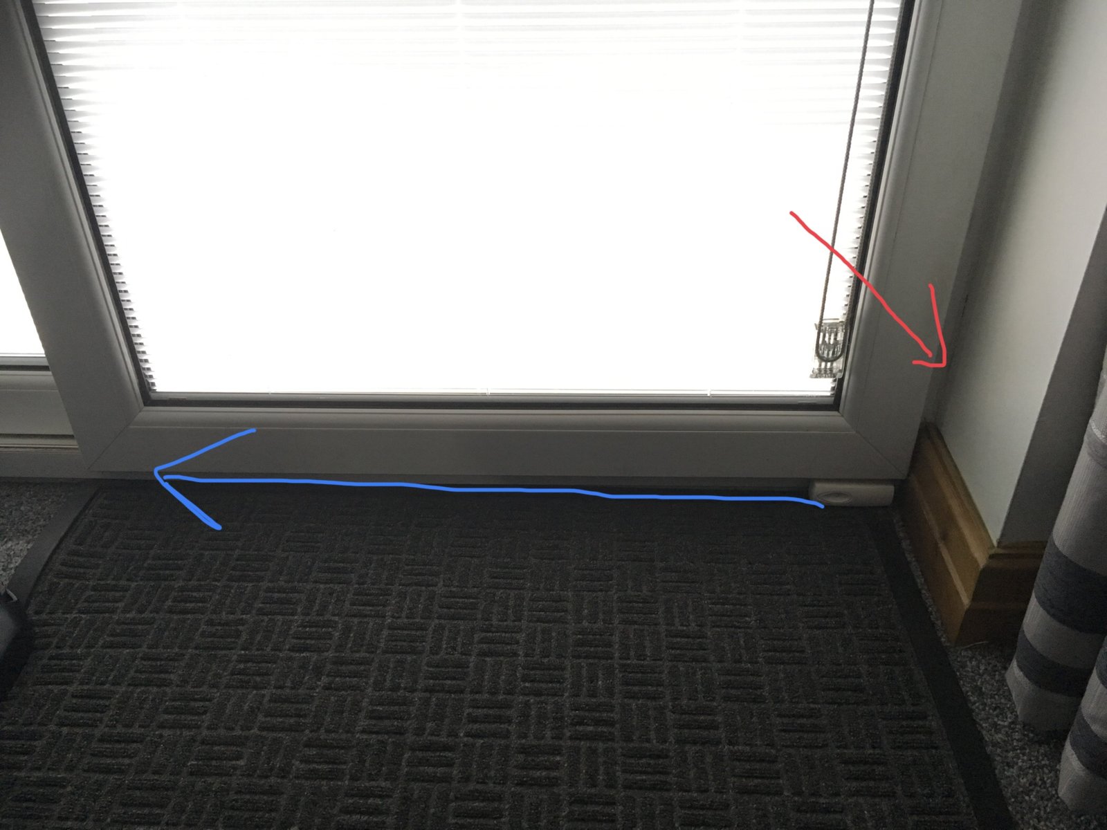

Ah right, so I’d need to disconnect it in the control panel first then? I wasn’t sure if it could be done via the local panel using the engineer code. I’ll post a picture showing what I want to do.
My intention is to fit a magnetic in the gap at the side of the door (red arrow) and move the impact sensor to the other side of the sliding part (blue arrow), underneath like it is now.
The reason is that if the door is open the dog keep catching it as she runs through. Also we want a magnetic sensor so if we go to set the alarm it will let us know if we left the patio door open as it won’t set.
Poor position for existing shock sensor
Door contact will be fine.
Moving the shock to the that new position is not advisable,too close to the floor to sense vibration correctly.
Would be better up the frame near lock.
Would need to see more photos of door for better position

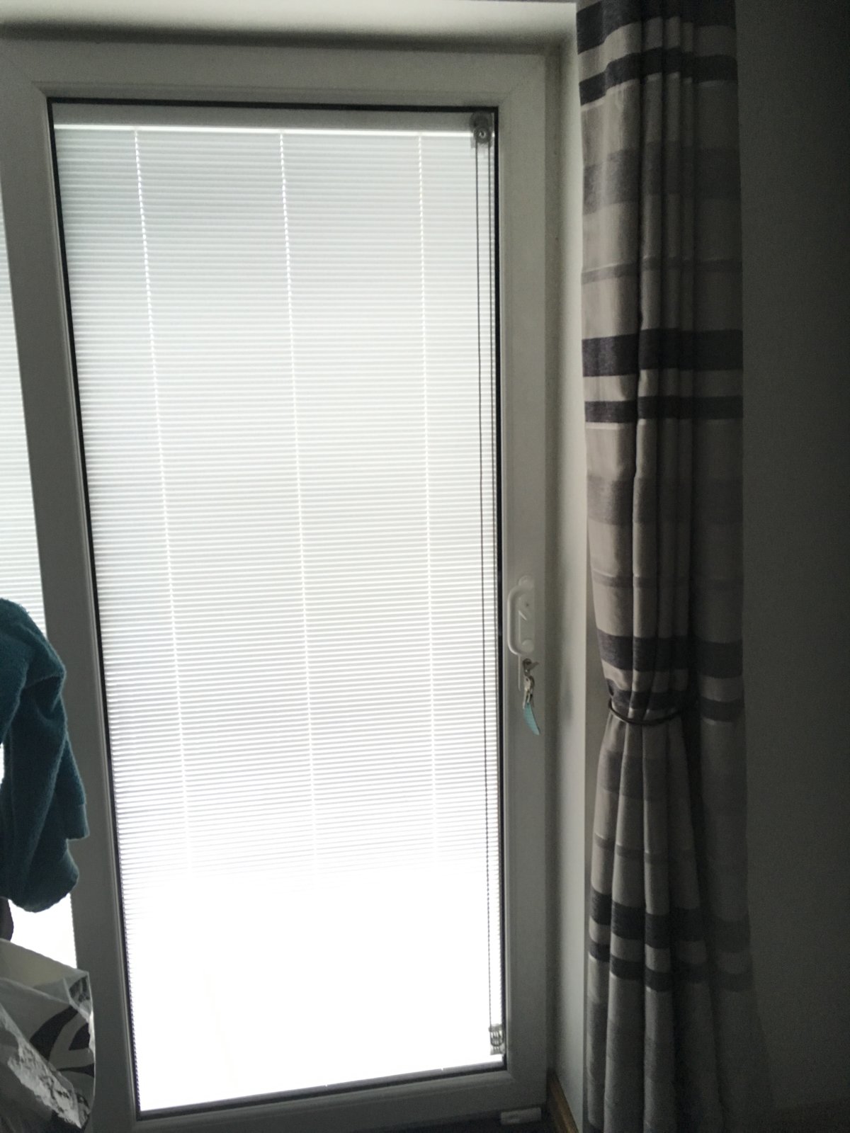

Thanks for the reply, I thought it was going to be ok but realised afterwards it is a poor place, ha. Here is a picture of the door. It is pretty tight to try anywhere else to be fair. I might have to stick to the magnetic on then.
That was why we fitted it at the bottom but as I said, when it is open it end up being a stepping stone, ha. Do you think it is worth fitting where I was planning or just stick with a magnetic?
Is there enough space to fit shock sensor down edge of the door ?
Texecom do a shock with combined door contact , but could be tight.
Otherwise go with the door contact
