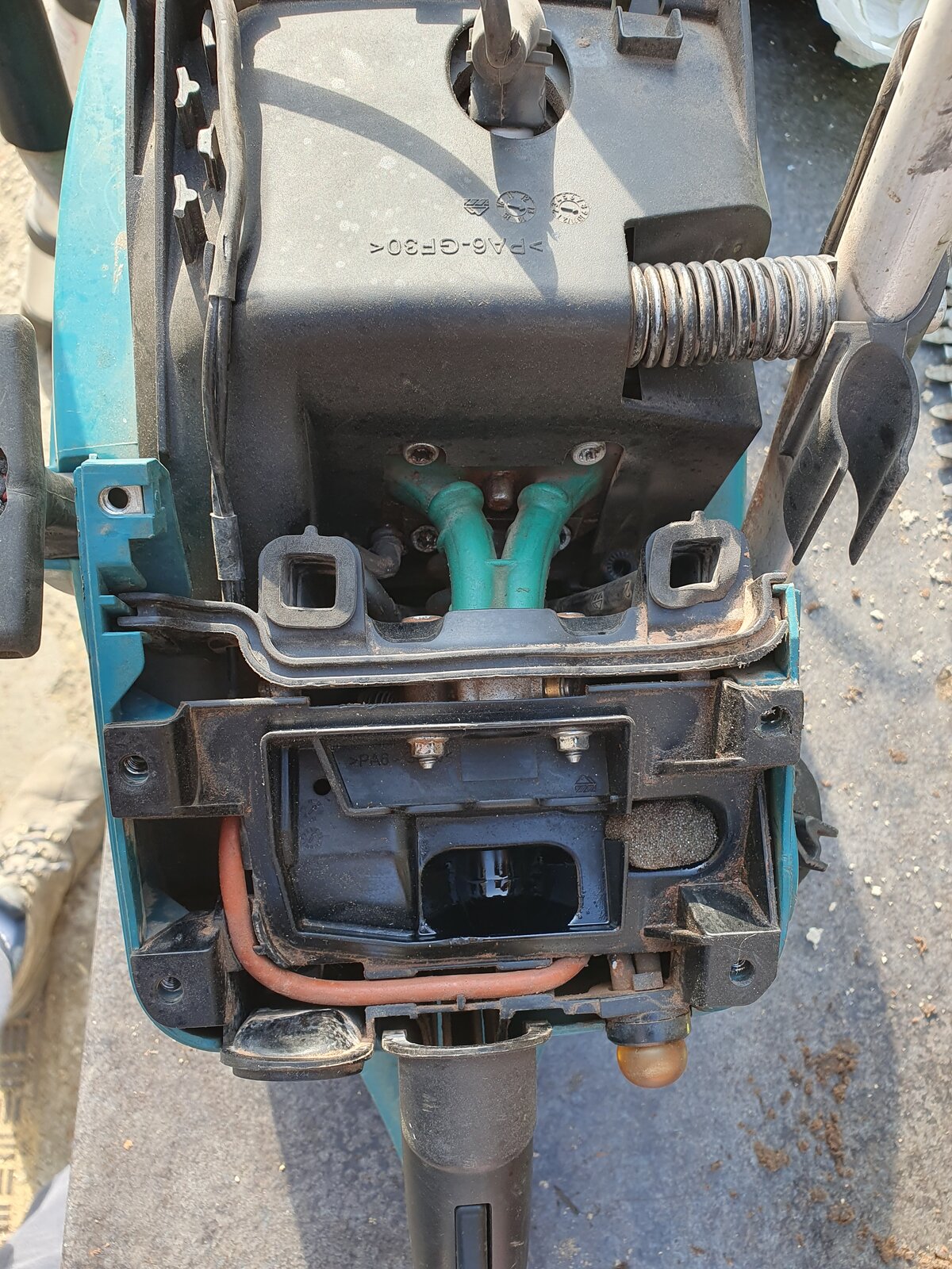

I had this makita EK6100 guess with carburetor issue and now want fix it but struggling to understand how carburetor comes out.
Stihl stuff are 2 minutes job but here seems to be very complicated.

Undo those two 8mm nuts and the plastic cover should shift but you'll have to release the two blue fuel pipes as you draw the carb back.
The primer button will also have some tubing to take care of.

Been playing all afternoon. Not that simple. Seem like everything need to slide up but still won't come our. Not sure what holding it
