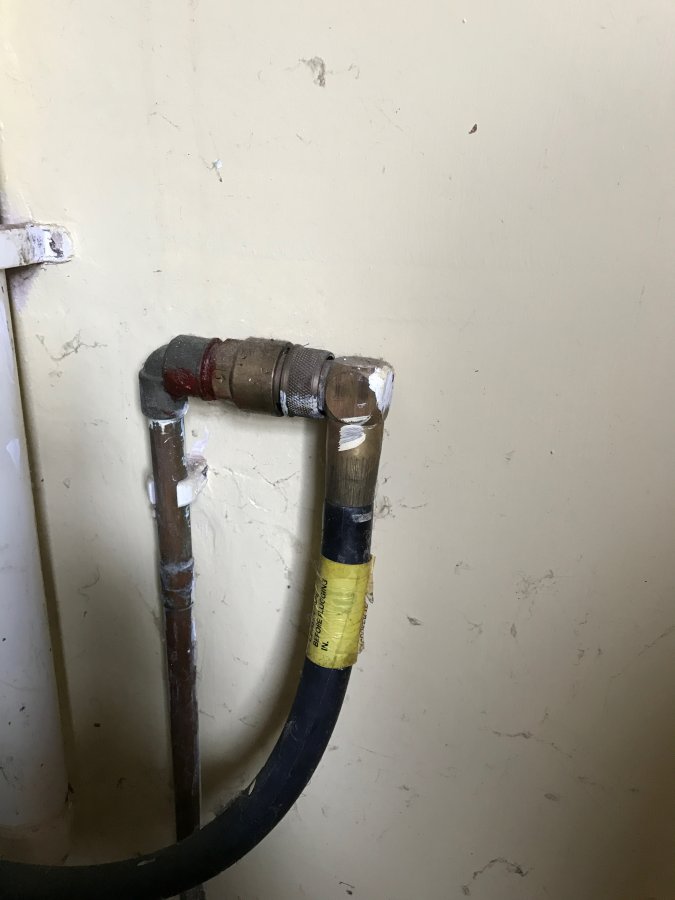

I am moving house so need to disconnect the gas oven and need to know how to do this. I'm not sure if this is a bayonet fitting or not. Can anyone advise please?
Thanks,
David.
You need to push the knurled ring upwards and turn it about 20 degrees and then it should be free and pull down.
Better to turn off the gas at the valve at the meter when leaving the property.
Don't forget to take the meter readings!
