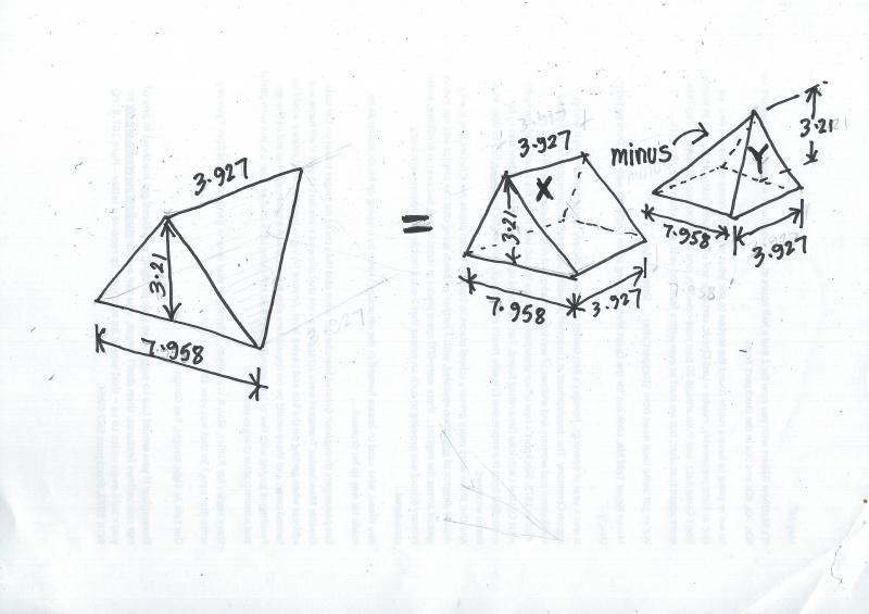

Hi,
I have a Cert of Lawfulness on a hip to Gable Loft conversion, on a semi detached house.
My architects calculations on the plans show an increase of 48.28 cu mt.
The councils 'delegated report' calculates an increase of 40.9 cu mt.
I went to the council - but they refused to run through how they calculated that figure.
I have checked the dimensions of the plans at 1:50, and they look correct.
I cannot work out what my architect has done with the hip to gable volume calc:
7.958 long x 3.210 high = 25.54m2 divide by 2 = 12.77 m2 x 3.927 ridge length = 5.16 m3 divided by 2 = 25.08m3
Its not how I would do it, I'd use:
Finished Gable volume: bhl/2
(ie (7.958x3.210x6.257) divide by 2 = 79.91
Existing Hip Volume: bhl/4
(ie (7.958x3.210x3.297) divide by 4 = 21.05
Plus remaining gable:
Existing Ridged Part Roof Volume:
(7.958x3.210x3.297) divide by 2 = 50.15
So 21.05+50.15=71.20
79.91 less 71.20 = 7.99 cu mt
So I make the hip to gable enlargement 7.99 cu mt, my architect 25.08 ... who is right.

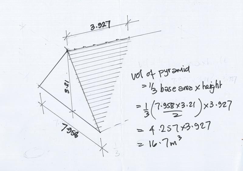

Your architect should go back to school and learn some basic geometry.
What he has done is;
1. worked out the area of the gable to get 12.77m2 (correct)
2. multiplied this by the ridge length to get a vol. of 50.14m3 for the prism (correct)
3. halved this to get 25.07m3 (totally INcorrect).
The true volume increase is as shown on the calcs. with the little sketch.
However, all is not lost. You can build the dormer up to the ridge, and up to the flank walls each side, under a Bulding Notice, for which you do not need plans. This means that the plans you already have would be useless. Personally, I think your architect is incompetent, and that you should ask him to either 1. re-draw the plans properly or 2. refund your money and get someone else to do the job.
There will be sites giving the volumes of various solids, but for a simple pyramid-shape (which your hip-to-gable is), it is always; one-third the base area multiplied by the height. In your case, the base area is the area of the gable (ie 12.77m2; one-third of this = 4.25; multiply this by the extended ridge length of 3.927, and you get a vol. of 16.7m3. Simples....

Frank,
you've used 3.297m in your calculation, where Tony has used 3.927m...a subtle - but very important - difference :P
You've used 3.927 in some parts of your original post, and 3.297 in others. All of the workings are correct, just the numbers used differ.
Run through your calc again using 3.927, and you will get 16.7m ³ .
You asked why Tony has used 3.927 as the height. It's counterintuitive, but as long as the prism has a base and triangular faces (which it does) the formula (1/3 base area x height) works. It doesn't have to be symmetrical to give the correct answer.
In fact, it's the same formula for cones too, so works as long as the object has a base, and tapers to a point.
Frank;
You need to be sure in your own mind, so lets take this step-by-step.
(note; I can't find the division symbol on my keboard so I'll use / instead).
1. In your first equation, you wrote;
7.958 x 3.21 x 3.297 / 6 =14.03 cub.m.
The error here is that in the third term you got the '2'and '9' mixed up;
it should be 3.927, not 3.297. If you re-work it out it will come to 16.7.
2. If your architect tried the method in your scond go, it is an a**e about
face way of doing it, but it can be done as follows; (I will re-write the
figures line-by line as you have done them but corrected; follow them
carefully and you will see it);
volume of triangular prism (area of triangle x length)
7.958 x 3.21 = 25.545/2 = 12.77 x 3.927 = 50.14 cub.m.
volume of pyramid = base area x 1/3 height;
7.958 x 3.927 x 3.21/3 = 33.43 cub.m.
so volume of additional segment (ie prism minus pyramid)
50.14 - 33.43 = 16.7 cub.m.
Method 2 is the long-winded way and unnecessarily complex.
In answer to your final point; imagine your house-roof stood up on end. The triangular gable will be the base of the pyramid, and its height will simply be the enlarged length of the ridge. Remember that a pyramid does not have to have a square base like those in Egypt; it can have a triangular base as well.
See if the attached sketch helps with method 2, but I would avoid this if possible in your dealings with your so-called architect. Keep it simple, ie volume = 1/3 base area x height.
(Ronny; You were 25 minutes before me but I wasn't cribbing! - it just took me ages to do that c****y little sketch!)

The author of the book also needs to go back to school.
On the right-hand side, look at the second diagram down; it states the volume incorrectly as bhl/4, when it should be bhl/3. All the subsequent calcs based on the book's method will be wrong, so disregard them completely.
Assuming the dormer dimensions are those in the 'cloud' diagram, then the volume of the dormer part will be;
5.25 x 2.456 x 3.6/2 = 23.2cub.m.
Add to this the correct volume of 16.7 cub.m.for the hio-to-gable, and you get 39,9 cub.m. This accords roughly with the Council's figures, allowing for slight discrepancies in reading off measurements.
I would say that you have another 10 cub.m. to play with, which is why your neighbour has a bigger dormer.
You have all the info. in these figures; remember that the vol. of a pyramid is always 1/3 base area x height, so go and give your 'architect' some earache (and do let us know how you get on).
