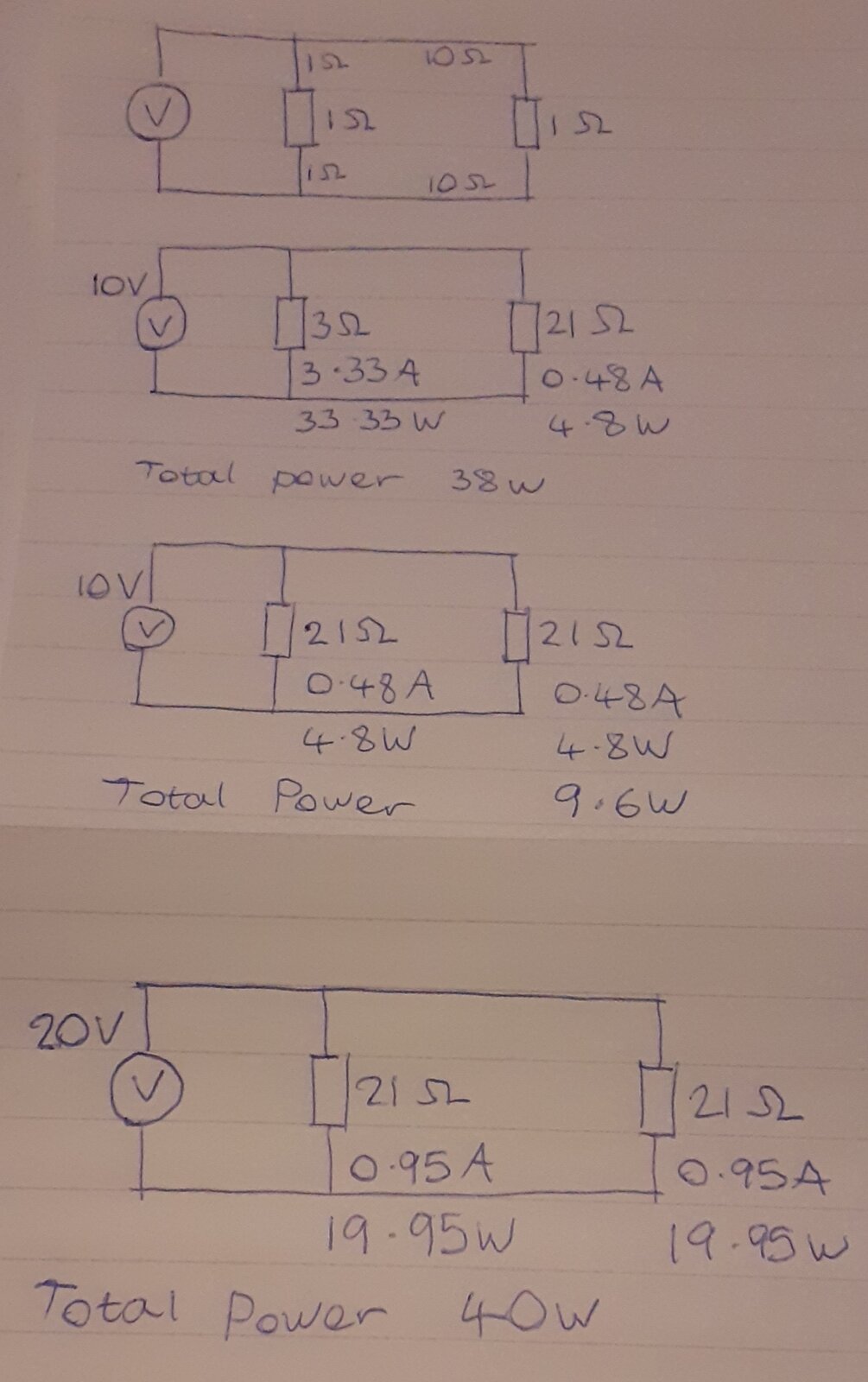

What is actually happening when you "Balance a rad"?.
Well, you simply restrict flow through it.
That is it. You may, be restricting flow through it based on thermostat readings, charts and calculations, or via the readings of your bag of psychic crystals, but all you are doing is restricting flow, and output.
Why would you do that then?
Because you want the rad to output a lower heat, which in turn, means a higher temp delta between inlet and outlet.
Why do you want to do that?
well, you could be heating the room too quickly for the control system to keep pace (Hysteresis error), or, you may want to push the capacity of the rad up or downstream because that other(s) rad are being starved, or, the boiler isn't able to do it all.
In other words, bad design.
You've added a speed limit to a critical device(s) in your home.
So, the reality is you are not "Balancing" anything. You are hobbling it.
You are restricting flow through a device for some reason.
The reason being static assumptions of a dynamic environment.

Is it a cold day, all the rads on and boiler working away? You've limited the rads to x temp drop. If the boiler is able or not because other rooms or zones are hot, your rad isn't going to go any "faster". It's been hobbled.
You may have a strong boiler with plenty of capacity. Durn't matter. Those rads have one speed only.
A normal cold day, but one room ahs the door left open, or a window open because granny is cooking in it? Durn't matter. The rad can't go any faster than it's been balanced too.
So what is balancing actually doing here? It's taking from Peter to pay paul. Why on earth is this a good idea?

Thats 4 levels of change in the system. There is not a fixed point to "balance" against.
You might have had some rationale to "Balance" the old, static system if you've bad design, but forget about if for modern designs.
By hobbling the rads in a modern system (Well designed) because some old retired heating engineering clutching his 1986 copy of the industry best practices still thinks pumps have 1 speed and boilers 1 output, you are doing far more harm than good. you are putting your foot on the throat of a system and doing nothing of benefit. You have a modern, well designed system, a boiler (likely over spec'd) and rads and controls able to react rapidly and dynamically and you then shackle them to a outdated concept.
Just come home from work and want the living room to heat up quickly? Give the electronic TRV a twist on your modern dynamic heating system and off it will go, but rate limited to a crawl because.....
"Yea but, overshoot, over heating, blah blah blah" Well, no, modern thermostat are smart and learn the heat profile of the room and adjust accordingly. TRVs are a proportional control device as well. Unless you have a 10KW rad in a broom cupboard, Hysteresis is not likely going to be an issue.
But then lets return to the point above about static flow control in a dynamic system.
We have a practice (Throttling) based on static observations in a dynamic system and environment.
you've set the lockshield for the system working at full bat (as per guidelines) but the PP pump is tickling along because it only see's one rad open. Fail.
You set the lockshield for the boiler running at full pelt. It modulates because it only has one rad to heat. Fail.
You set the locksheild for a full zone open. Only one rad is calling for heat. Fail.
