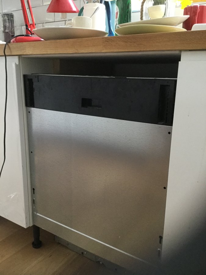

Silly problem, want to fit my new kitchen door to my new integrated dishwasher and somehow i lost the attachements so i have no idea how to fit it. At the sides of the dishwasher door there are some holes that i assume are to put screws but my problem is the top section. It looks like it needs some special bracket. Anyone knows how to do it?
Normally you would have a template that comes with the Dishwasher and fixing kit.
The template will then show you where things go.
There will be two screws that fix to the reverse of the door that slot into the holes at the bottom of the appliance. Then you remove a couple of screw from the top of the Dishwasher and then insert two longer screws that secure the door in place. This should be aligned correctly prior to committing yourself.
