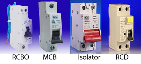

So we start at the beginning, it's a very good place to start, the consumer unit (CU) 1722980262996.png this will normally have a load of devices, there are different ways of doing the same thing, but it will have some of these PartID_CU.jpg in most cases, up is normally on-down off-up, there is a feel to them, so if there is a fault MCB for example, switching it on/off you will feel a different resistance to the leaver.
