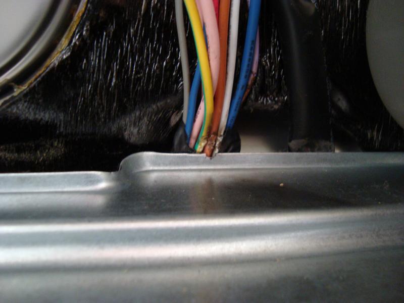

Was loading the dishwasher when there was a flash and bang from the hinge area. Checked consumer unit and the circuit breaker had tripped (32a), but not the RCD. Took off the back panel of the washer and discovered that a wiring loom was relatively tightly pressed against the edge of part of the internal metal frame of the washer. Over time they had rubbed against each other and eventually exposed a number of wires which I assume then shorted (see picture).
It’s clearly a design fault and would suggest a dangerous one at that, but I’m curious to know why the plug fuse did not blow (13a) or the RCD trip. I thought RCDs was designed to check against a earth leakage which I assumed would have happened here as surely the metal frame would have been earthed. Also, how dangerous is it?

If your RCD hasn't been mechanically tested with the test button for a long time then the mechanism could be 'sticky' which allowed the MCB to operate first. An MCB will operate with L to N or E faults as well as overloads
An MCB will almost always operate before a BS1362 fuse.

I've had this happen twice on me a few years ago,, different dishwashers BTW
Cables at the bottom of the door were either fractured due to their constant bending (opening & closing door) or were rubbing on the framework!!
Short answer speed. The magnetic part of the MCB likely worked faster than the RCD could act. The fuse is an odd beast. The 13A version is quite slow to blow, but in some cases we fit fuses as they are faster than a MCB.
However I would still test the RCD. One should use the special tester in order to measure time. But the mechanical test button built into RCD will normally highlight faults other than faulty build of label which would have been found when it was fitted.
Do check size. 100ma - 300ma RCD is used with a TT supply to protect against fire. But in a modern house we use a 30ma to protect personal. But the 30ma does trip easy so common practice is to use more than one RCD in a house. The more RCD's used the less they are likely to trip for no reason. Hence the move to RCBO's which build the RCD inside the MCB.

This dishwasher is only 3 years old.
The consumer unit was new about 14 months ago. I have tested the RCD and it tripped as soon as I pressed the test button. It's an 80a 30mA one.
I have reported this to the supplier Kenwood (Currys) and they are arranging for it to be inspected although it's outside of guarantee.
