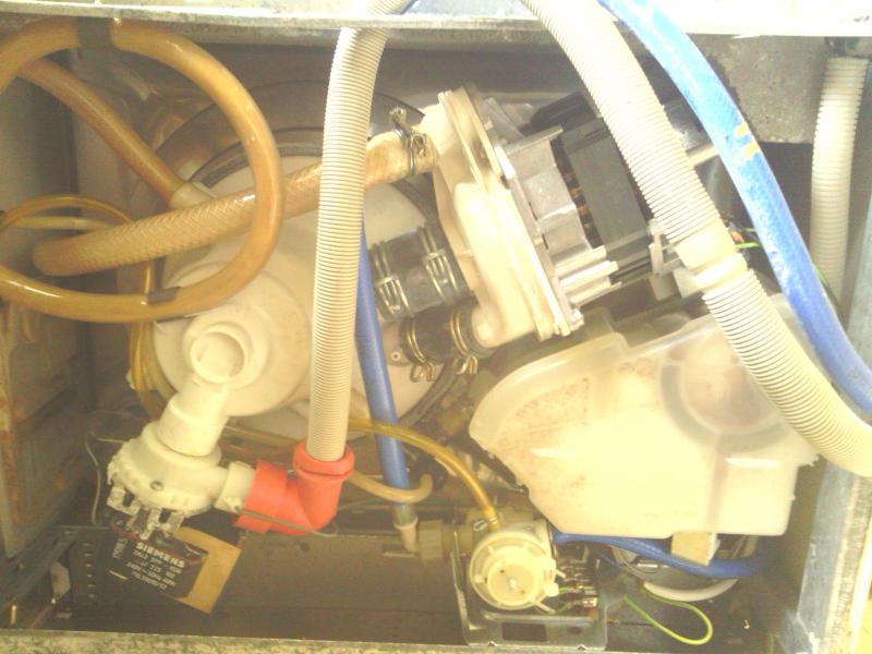

I just got back from holiday, ran my dishwasher, and it failed to drain. I ran it again and still it wouldn't drain. It's over 20 years old do I can't protest too much. Anyway I drained it with a glass, tipped it on its side and took the attached photo of the base.
Is there anything I should try before buying a new machine? The hose isn't kinked or anything. My suspicion is that the black thing marked "Siemens" in the bottom left of the photo is some sort of motor to drain the water and that this has stopped working.
Grateful for any help.
Fixed this last year. I wasn't able to unscrew the impeller as the man in the video suggests but as far as I recall all I did was take the outlet hose off and run boiling water and detergent through it. Now it's happened again and it's a bit frustrating that it's so soon, but I think the drain hose getting blocked is the problem.

I expect that its an induction motor which does not have brushes.
You may be able to put your finger up the pipe and see if the impeller is free to turn.

OK I'll look at that next time. But do you think that is consistent with the fact that the drain hose seems to be getting blocked.

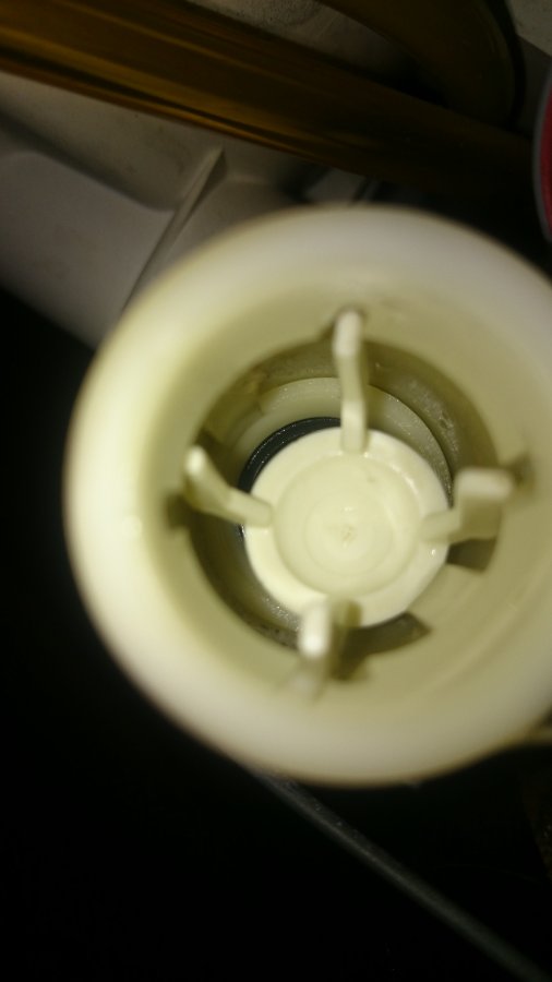

OK, it's happened again so it's time to buy a new one. The fitting for the pipe is as per the attachment. I can't get my finger up it very far because there is a piece of loose plastic fitted in there which won't come out.

Took the outlet hose off and ran boiling water and detergent through it. But I don't have any evidence that the problem actually is due to the outlet hose getting blocked. It might be that the act of tipping the washing machine on its side to access the outlet hose is freeing up something inside.

Tilting them causes something that sticks, to loosen up and unstick I believe. Tip I found in the 'Appliances' section of this forum, when my Beko machine wouldn't drain. Don't know if its a common fix with most dishwashers though if they wont drain.
