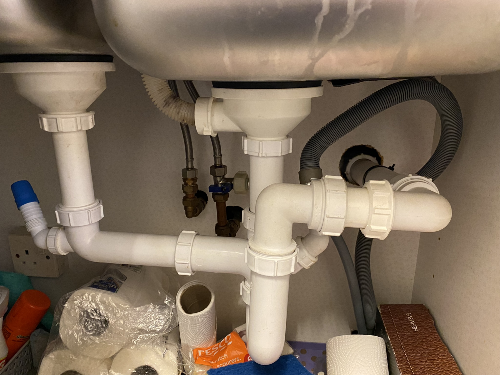

The pipe arrangement we have is not ideal as the waste pipe in the back of the kitchen unit is quite high and too high to use the U-bracket supplied with the machine (which is long gone now) however I have always had a loop of the drain pipe cable tied to be well above the level of the outgoing drain:
I've disassembled and cleaned all the pipe work in the photo a couple of times since the problem started, and I've also tested the drain pipe heading through the back of the unit is clear and will accept a high flow rate without backing up, and nothing has changed about the configuration of the pipework in years.

So what am I missing here ? Looking at the pipe layout it does occur to me that the point where the dishwasher attaches to the trap will be lower than the natural settling level of the trap - which will be in line with the bottom of the right angle bend in the foreground - so there is certainly potential for syphoning there despite the high arching loop, but if so, how did it operate for 5 years without syphoning back into the machine ? What changed ?
Unfortunately the height of the drain pipe through the back of the unit is above the level of the trap and I can't change that.
About the only thing that I can think of that might help would be to change the pipe section with the cable tie on it to one with a joint for the dishwasher to connect there, downstream of the trap level, but I'm not convinced that that would completely prevent syphoning.
Any suggestions anyone ? Is it the machine at fault or the pipe layout ? And if it's the pipes why did I not see a problem for 5 years then suddenly its got much worse very quickly ?
Currently the machine is partially apart on the middle of the kitchen floor and now that I'm not sure whether the machine or the piping is to blame I'm not sure what my next step is..
Have you tried connecting waste to spare spigot on the left of the photo? You could change spigot to and anti symphony type ( has a flap on it which falls shut when not pumping).
The run of the waste hose is wrong. You have to loop it up to the worktop. Tie it in place with string and a cuphook or something.
It can also be achieved by drilling a hole in the side of the sink unit at the top, and passing the hose through that. Yours comes in at the bottom which is wrong.
The top of the loop needs to be higher than the water level in the sink when you pull the plug out.

No I haven't tried the left waste spigot (not sure the hose would reach) however due to the high exit pipe after the trap the effective settled level of the trap water will be above both spigots so I doubt that would help.
I've been browsing Screwfix and B&Q plumbing listings and haven't seen any "anti-syphon" spigots listed - where are they available ? I'd prefer to solve the problem without that approach if possible though.

There isn't actually any gap between the back of the sink and the back panel of the kitchen unit, nor to the right hand side - how the pipe is in the picture is the highest the loop can go without putting the loop completely outside the kitchen unit, and I'm not sure there is enough room or hose length to do that without a lot of modifications.
I should be clear though - the syphoning problem is not related to draining the sink - it happens even when the sink is empty. It's syphoning the standing water out of the sink trap.
I think I'm just going to have to change where the spigot is attached so that it's not below the level of the water in the trap. The best place would seem to be to install an appliance feed T facing upwards in the final run of pipe that goes back through the hole in the cabinet - that would be after the trap and above the water level in the trap and allow a natural air break to form.
The difficulty doing this is there is a mixture of pipes in use - from the sink until the front elbow it is mostly threaded 40mm with built in o-rings, however it then goes to 44mm with compression fittings for the rest of the run - which is a legacy of the drain pipes in the house that go to the outside.
All the appliance feed spigot sections I've seen to purchase are for 40 (or 32) millimetre threaded pipes not the 44mm compression type, so I'm going to have to change some of those pipe sections to be able to use a threaded pipe in that part of the run...

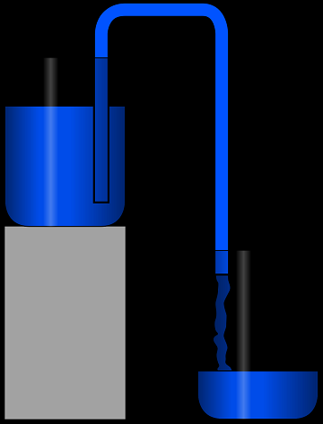

If you don't understand how syphoning works you shouldn't be giving out advice on a forum. Sorry.
Anyway, I've already tried temporarily raising the height of the hose as you suggest on previous occasions and it does not solve the problem.
This image should give you a clue why the height of the loop isn't relevant in this scenario:
As long as the trough in the bottom of the dishwasher is lower than the sink trap - which it is, unless an air break can form it will syphon back. An air break can't form because the exit drain is higher than the attachment point of the spigot for the dishwasher.
You keep going on about the water level in the sink when pulling out the plug - I've made it very clear that the problem is happening with an empty sink. You don't seem to understand the problem.

1. The inlet spigots for the dishwasher waste and the unused one on the left hand side of your picture are in both cases below the level of the waste pipe going out through the wall.
2. So effectively you have a very deep trap (U bend), which will hold more water than it should.
3. Hard to tell from the photographs but:
3.1 If you can shorten the pipes coming directly from the wastes to raise the trap by enough to raise the spigots above the final outlet pipe, that should clear your problem.
3.2. If there is not sufficient length to shorten, you need to move the final outlet pipe lower. Will mean removing the back of the cabinet and drilling a further hole through the wall. Quite a lot of work.
4. If you raise the spigots, you will have a clear air break above the U bend to break any siphonage effect.
5. I suspect you need to check the drainage out anyway. For a problem like this to start with no plumbing changes suggests to me you have a partial blockage further down the drainage path so that the waste spigots are being immersed in U bend water for longer than previously.
