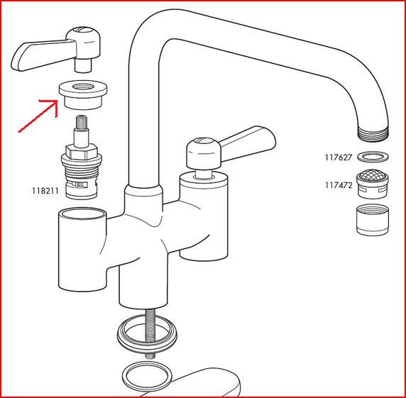

Have been doing lots of plumbing things recently but just when I thought I was all done, the kitchen tap decides to kick off and start dripping.
The tap is an Ikea Loviken mixer tap (Mk1, I think), with ceramic valves, and it is the cold side that’s dripping. I have read other threads online with people having success at taking their mixer taps apart and cleaning the ceramic discs. Happy to try this, but just can’t get the taps apart to get at the valves.
There seem to have been two versions of this tap – one (ours) was supplied fully constructed, and the other required the user to fit the tap handles together themselves. I am enclosing a page from the manual for the second type, with an arrow to the part that I’m having difficulty with.
When the tap handles are removed, there is a smooth chrome cap over the valve (with the splines coming up through the hole). It doesn’t appear to screw on, and I haven’t been able to get even a Stanley knife blade between the cap and the tap body. Have tried lots of WD40. Have tried (gently) inserting a hook into the small gap between the cap and the splines, but couldn’t pull it up that way.

it looks like it unscrews off , get a rag to not scratch it and use some pump grips to unscrew it
Thank you, AGAS. I had taken a few goes at trying to turn the covers (and the OH had tried too) but they wouldn't budge. Have just tried again and one unscrewed! Maybe the nine gallons of WD40 I squirted in eventually got to work. Now I need a different kind of wrench to get the valve out, but am one stage further on.
One cover is still stuck fast, but at least I now know that it *should* unscrew. Don't currently have any pump pliers, but I will go and get some and try that one too. The diagram looked to me as if the covers just slotted in, but you clearly interpreted it better than I did. Will try removing the valve and cleaning it, and report back.

if you manage to remove it to replace you need to count the spines on spindle to get the right one which can be a pain sometimes .
