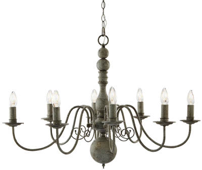

I am assuming that whatever the mass-produced chandelier below (as an example) has inside it would be what we would need, since it's operating on exactly the same principle, viz a single cable comes down from the ceiling rose into the body of the lamp, and is distributed in parallel to eight bulbs:

Multiple wires within light fittings are typically connected with closed end crimps, such as these: http://www.lampspares.co.uk/closed-end-plastic-crimp-connector-medium-nes25-plu66066
Exactly how it's been done in the wheel example or where they have concealed the wires and joints is unknown.

Electrically its fairly straightforward, there will be a join box in the centre where all the tails to the individual lights connect to a single supply cable. You can use a single 1g 25mm box and a blank plate as your join box.

I would use several small junction boxes. One above each lamp on the top of the wheel rim. Then each box has only 3 cables, one from the previous lamp, one to the lamp below and one to the next lamp. At one end the there is no previous lamp hence one cable is the cable from the ceiling rose bringing power to that box. The cable to the last lamp can go along the rim to the box above the previous lamp.
4w is only negligible if your enclosure can dissipate that much without heating up inside too much!
You could wire them up as a ring round the edge and spurs to each lamp. Although you needn't close the ring at the end. Then you only need 3 cores into each junction. Or do without the spurs and chain inside the lamp holder.
The ones you see in pubs tend to have small round J/Bs situated on the top of the wheel,using black or gold flex, an alternative to heat flex is to oversleeve in the holders with high temp sleeving you should not use normal jam jar lids, without adapting, the ones you see on sale have vent holes to let the heat out and usually thick glass, even with led lamps the temperature gets quite high and can eventually destroy the lamp.
